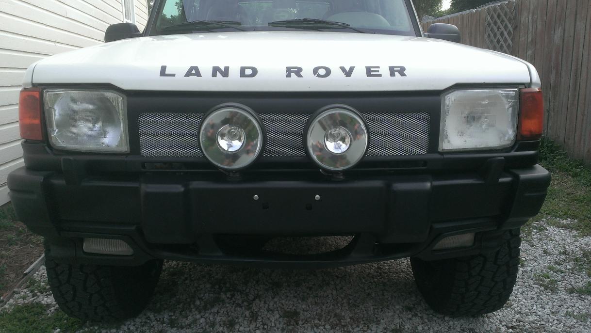

Ok, stick a fork in this project. I must say I really like it. Very clean lines. I also paint all the trim with flat black trim paint. I didn't have the LR sticker on for the pic but it's on now curing until morning.
The trick to this at least for me was to curl the bottom of the material under a bit to conform to the shape of the plastic at the bottom.
A jig saw made short order of cutting it out. As others have stated, cutting is easy, gluing metal to plastic, different story.
