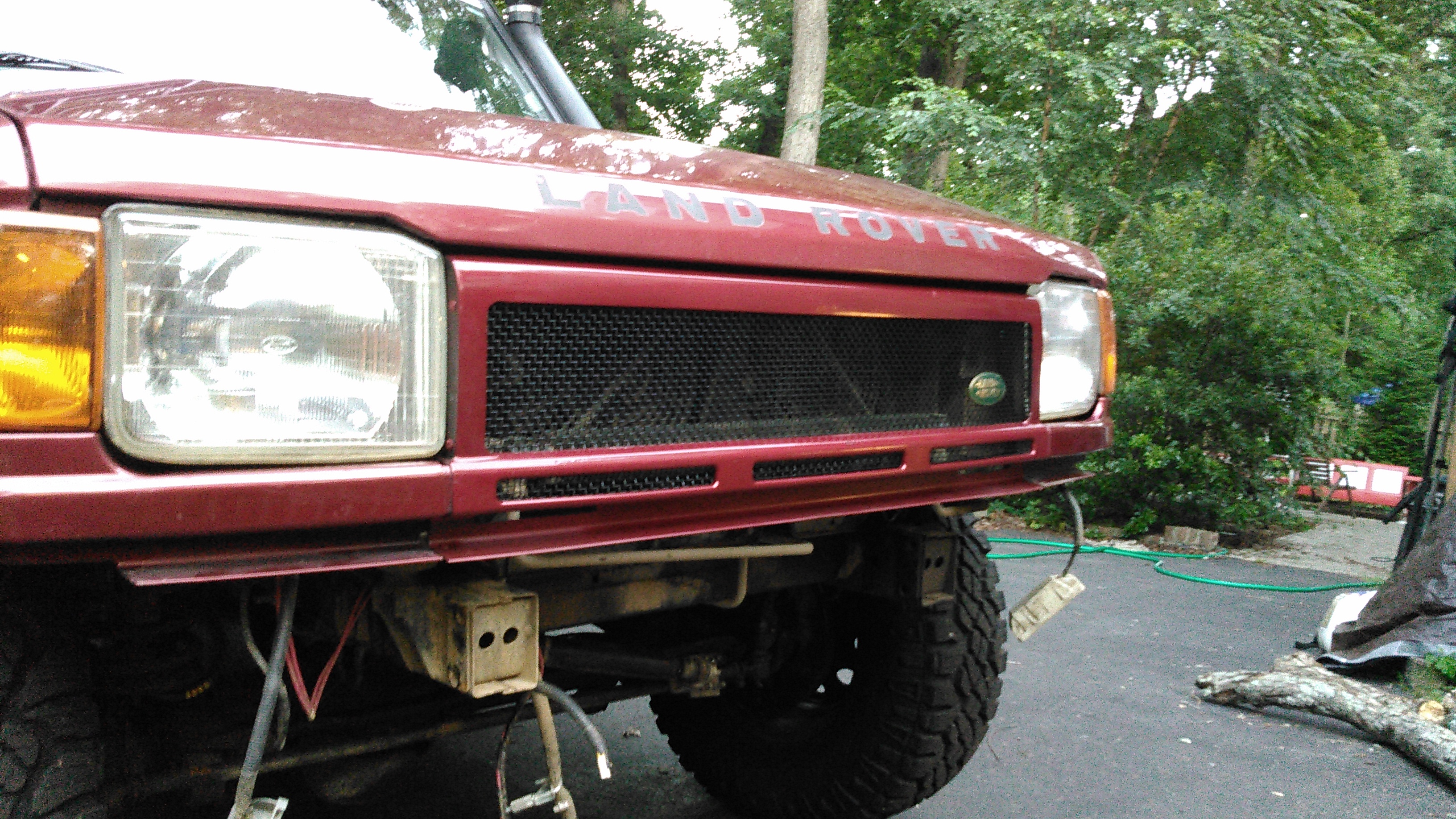

Old thread but figured I would throw in my homemade version of the saudi grill.
Contrary to what others said, I believe the saudi grill does help cooling by allowing more air flow, my temp has dropped from 206F to around 188F after the grill( and removing lights, ect. from ARB)
