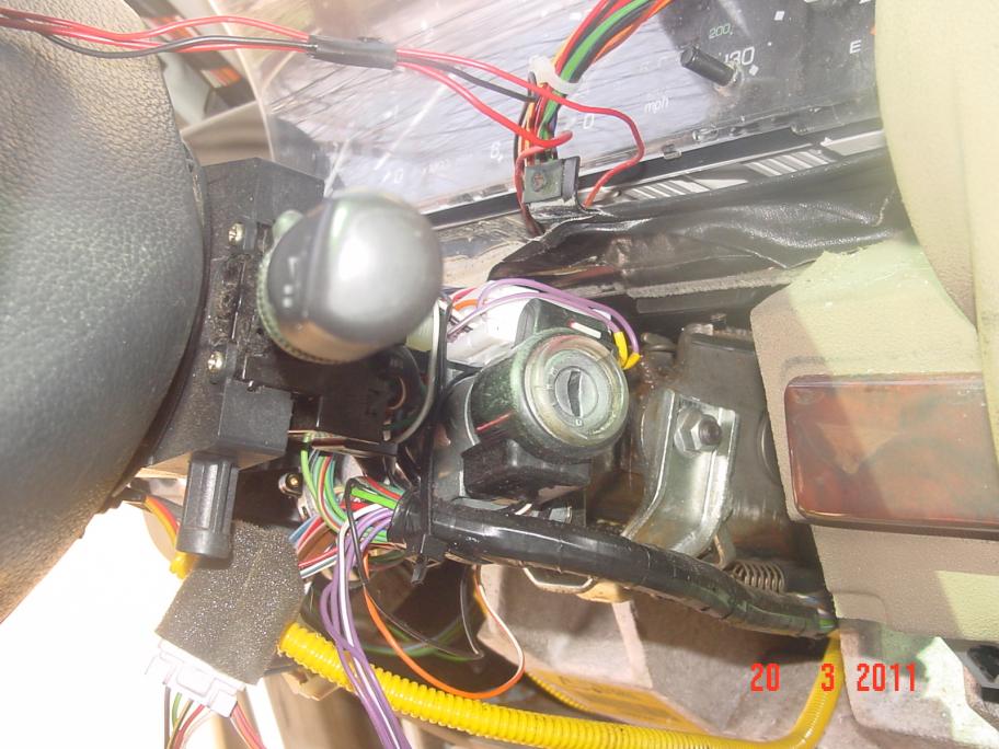

I put in the switch I got from Will. It works great, problem fixed.
Took a few pics with everything off for those of you who have yet to have the pleasure of tearing into the steering wheel clusterf**k.
The first picture shows the old switch still in and the two connectors on it.

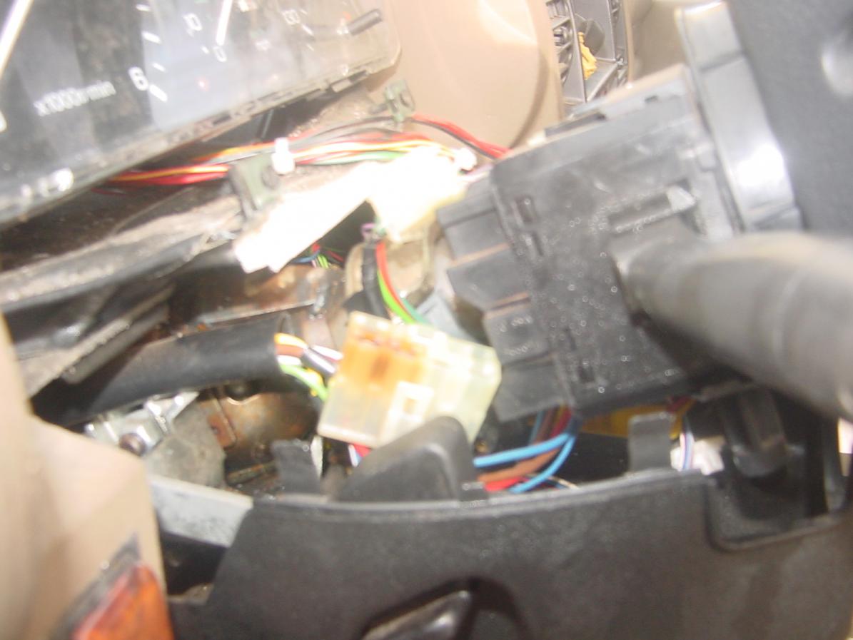

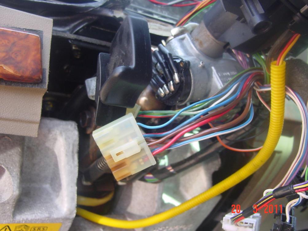

Second picture is with switch removed. Noted signs of overheating on the connector. You can also see the backside of the ignition switch with the ring of soldered contacts.
Third picture is the keyhole with covers removed.

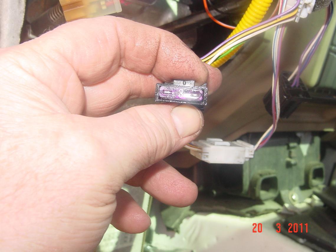

Fourth picture shows a 3 amp fuse and a small inline connector that is part of the wiring under the bottom cover of the steering wheel cluster.

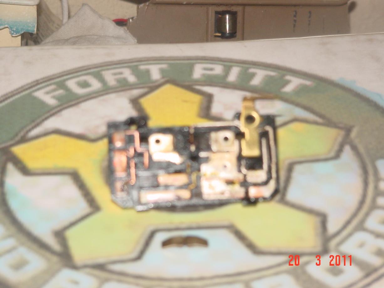

The last picture is the inside portion of the switch contacts from the old bad switch.
I did not like all the loose wires in the bundle and the possibility of damaging individual wires is high when working inside this area, so I retaped each group into smaller, well protected bundles to avoid pinching a wire while I had it disassembled so thoroughly.
My dimmer had also broken loose from the mounting points, so I enlarged that opening slightly to allow it to protrude more, cut down the broken mounting points and used a different mounting screw to reattach it.
Now my dash lights and tail lights all work properly again.
