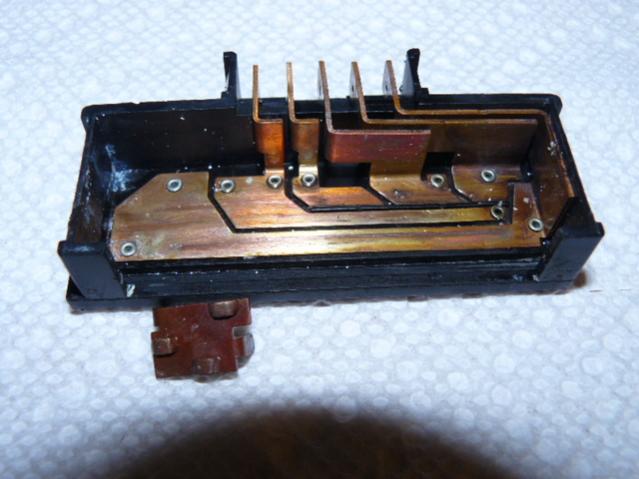

The actual slide switch is prone to problems - see https://landroverforums.com/forum/di...picture-51871/

Full speed bypasses the resistor, so if your blower doesn't work on full speed it's probably the switch. The resistor has no moving parts so is unlikely to be intermittent.
Sounds like all of you probably have switch issues, but there's also the blower motor relay, the Ac switch and the fuse in the engine compartment to look at.

It is the switch, it is always the switch on the DI, always.
Take it apart, clean it, put it back, fan works, everytime.

It takes 10min, do it while the other things are draining.

For some reason I thought it would be more involved. Add that to the list of todo's for tomorrow.
