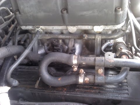

Oh and also I started getting coolant in the passenger side of the vehicle... is that the heater core?

Heater core highly suspect, and easy to bypass for testing. Don't need heat in Noxubee county this time of year.
Getting to the switch for me involved taking off the front of the dash AC control parts, and that allows you enough access to spray.
