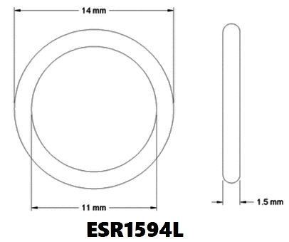

I've been reading through a bunch of threads to see what other stuff to do along with a radiator swap. One thing I can't pin down is the size of the oil and transmission cooler line O-ring ( o ring oring ). Are these little items truly not available via conventional o-ring procurement methods? Like, the local auto parts store's box of random metric size ones for $5.95? or is our only recourse sourcing these replacement seals for the factory cooler lines paying $2.95 each at... Somewhere? (No offense, Somewhere. I use you for a lot.)

The Orings ( OE#: ESR1594L ) can be had at any NAPA, Hydraulic Line Shop, Good Hardware Store, etc.
Just get BUNA-N Oil Resistant Orings in the following size:
OD: 14 mm
Width: 1.5 mm

I just looked at some OE o rings in the LR bags and from my Bulk supply....
The cross section shape of the OE ESR1594L is round, and made from a buna-n oil resistant rubber.
The Radiator Adaptor ( ESR1262 ) accepts a round o ring, and that's all I've used with zero issues.
I've seen OLD/USED ESR1594L o rings look like a flat washer but not a new one.
That's all I got, good luck!

I found the specs on this awesome forum and ordered a bag of 100 for $4.99 from Amazon a few months back. At the time they were an add on item and it looks like they've now increased to $9.99. I only used 4 of them for my radiator swap, so if you have the time to wait shoot me a PM with your address and I'll mail you 4 for your project.
by
Sterling Seal & Supply, Inc. (STCC) Sterling Seal & Supply, Inc. (STCC)
M1.5x11 Buna-N O-ring, 70A Durometer, Round, Black, 11 mm ID, 14 mm OD, 1.5 mm Width (Pack of 100)
See all 536 in this Product Family See all 536 in this Product Family
4.3 out of 5 stars
48 customer reviews 48 customer reviews
Price:$9.99 ($0.10 / O-Rings) & FREE Shipping
Best price
Product Specifications
Part NumberM1.5x11
Inside Diameter11 millimeters
Item Diameter14 millimeters
Model NumberM1.5x11
Number of Items100
Width1.5 millimeters
Item Hardness70 A Durometer
Measurement SystemMetric
Cross Section ShapeRound
Lower Temperature Rating-30 degrees_fahrenheit
Upper Temperature Rating250 degrees_fahrenheit
Brand NameSterling Seal & Supply, Inc. (STCC)
ColorBlack
Durometer Hardness70 _ A
