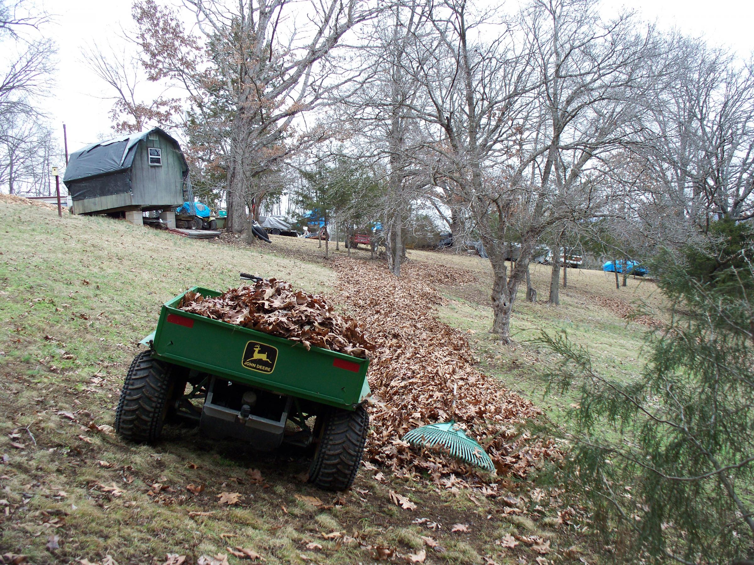

Yes, I agree on the leaves. I am surrounded by oak trees and spend weeks annually picking up leaves on two acres or so in the fall. I bought a used Olathe 48HL sweeper some years back which helps tremendously on the areas that are flat enough, but this is NW arkansas and not much is flat around here.
