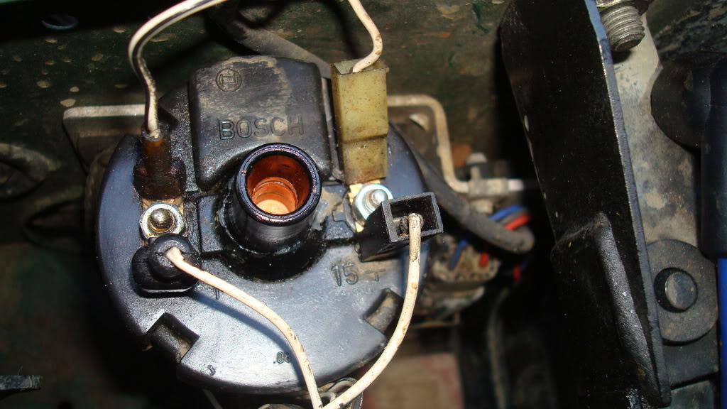

Make sure the bulbs themselves are functional by removing them and testing them and checking the contacts in the bulb housing....
You said there were four wires next to the coil but not attached to the coil..... does you coil look like this? How many wires ARE plugged into the top of the coil? In my pic the HT lead is removed but the other wires (to ignition switch and amp) should be connected.
Does your Distributor still have its amp attached to it or has it been located somewhere else? Have you chcked your reverse light switch?

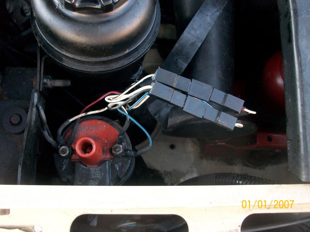

the wires i was concernered about are at 2 o'clock to the coil in the picture, and all fuses check out
Attached Thumbnails patience wearing thin 94 Disco still won"t start-100_4181.jpg

oh and the amplifier is on the side of the distributor, when I did check the spark it was bright white didn't seem weak at all.... do all rovers come w/a crash course in diagnostics or did I just get lucky
