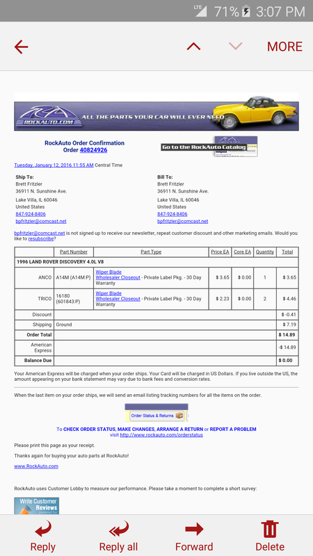

I have just bought new blades all around for my D1. They are the single piece curved style. Less than $15 total shipped from RockAuto. The rear blade is great! Its the first time in the 3 years I've owned the truck that rear blade actually clears the window as it should. Fronts are good, too.
Here's what I bought.

hmm... Fish, it seems they recommend 14" blades. I've been using 15"ers (which are small enough to fit on the glass only, they don't touch the rubber which surrounds the glass). I wonder if that makes the difference?
I'll give it a go and report back.

14" blade from RA as posted by FishEH (vs 15" Bosche) seems to have done the trick!
Thanks!
