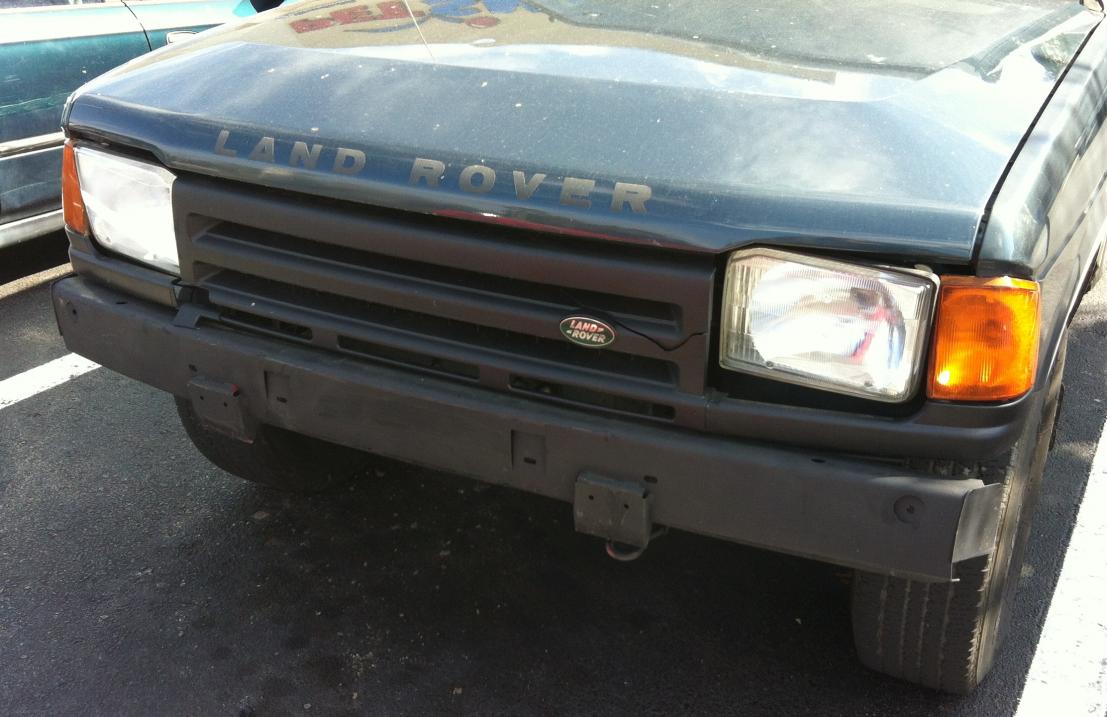

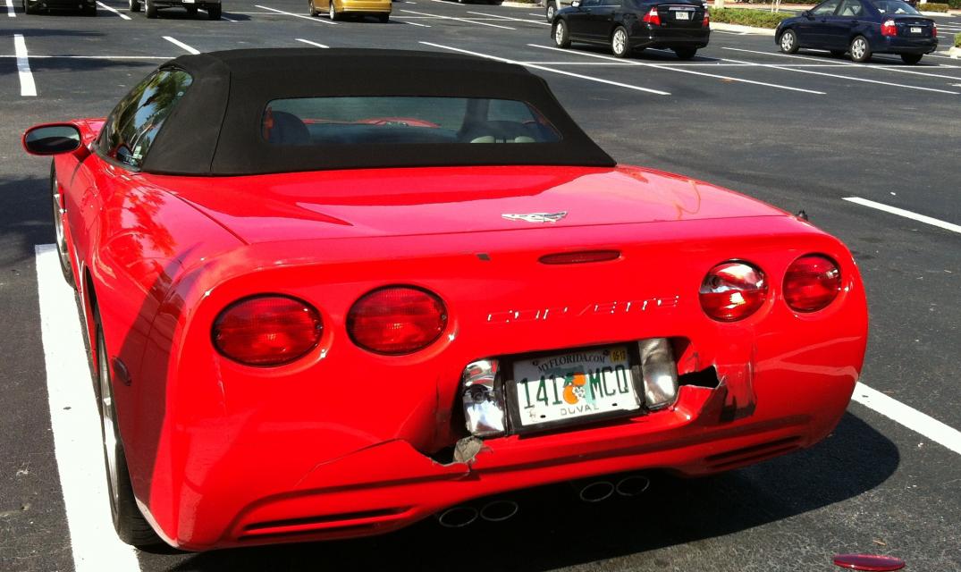

Went to the store and as I was putting it in park my foot slipped off the brake.
Kissed the unoccupied car in front of me.
me:
Him:
Popped my headlights back into place, wiped the red paint off the bumper and drove home.
Anyone got a used grille for a 96 Disco?

Please tell me you're joking and that you didn't just break the law and then brag about it on this forum!?

You did leave your info for that person right? If not soon you'll get a knock on the door, I'm sure it was recorded on video.

Calm down everyone...you guys take stuff too literally...
Reports were written, info exchanged, once the owner came out i was there and bought him a Starbucks while we waited.''
Crikey people - calm down!
I was referring to the damage sustained!
