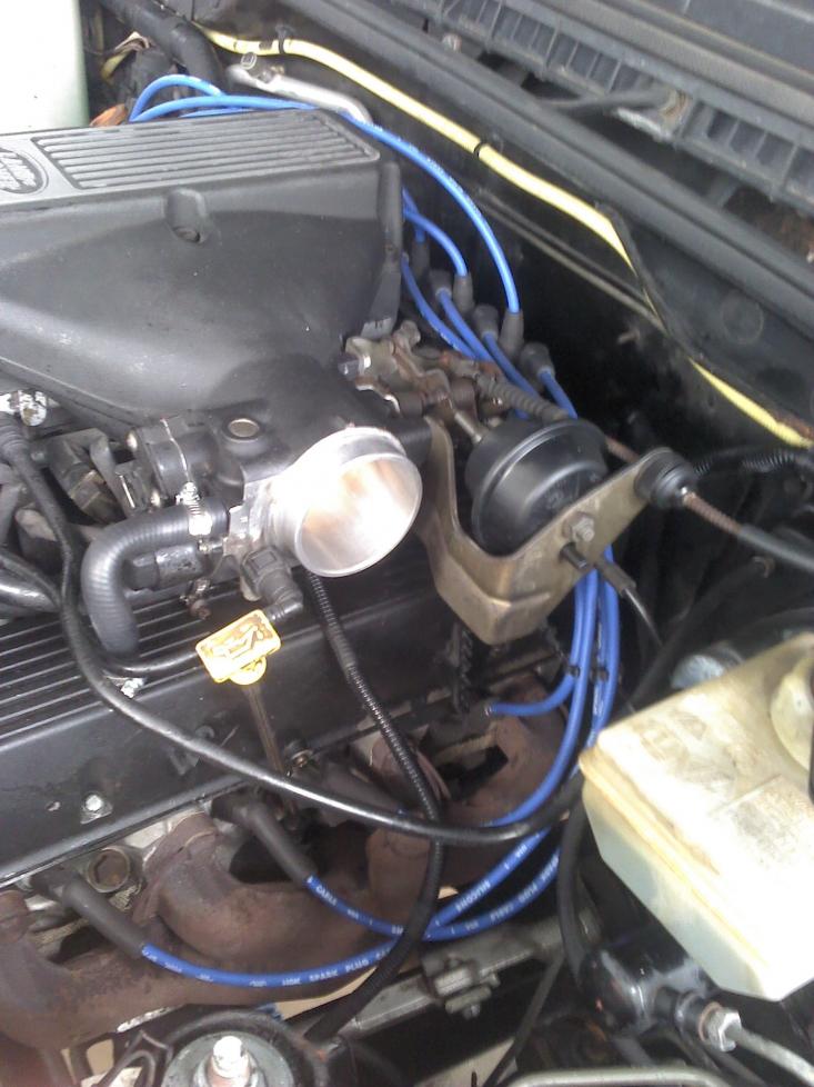

thanks for asking. epoch day in my new life as a wrencher.
-throttle body clean
-maf clean
-engine wipe down
-fixed damn leaky power steering fluid hose - if i could do it why couldnt the mechanic
-new champion plugs (gapped)
-new ngk wires
-lot of beer. rums gone.
Attached Thumbnails So what did you do to your Disco today?-2012-03-31_18-21-21_777.jpg   So what did you do to your Disco today?-2012-03-31_16-57-20_757.jpg

Originally Posted by slanginsanjuan
I recommend reversing the boots so those wires point up and away from your exhaust manifold. You'll melt your wires in no time running it like that.

Slang,
Like he said, rotate the plug boots about 180 degrees to give more clearance from the hot exhaust manifolds. I hadcto add a couple more wire combs to help route mine. Advance has the combs cheap.
Route the wires higher alo0ng the side of the upper part of the engine.
