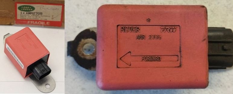

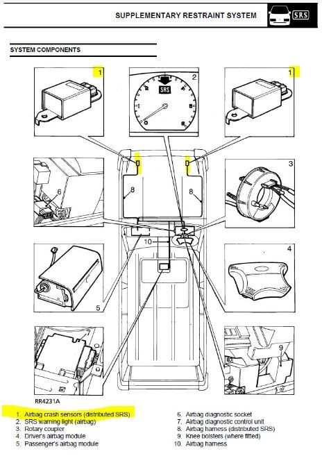

EDIT.... in another thread the question was answered correctly.... it is the amplifier module.
Would have helped but he didn't post the 3 pics in the other thread so.......
That's the SRS sensor AMR2705 (there are 2)

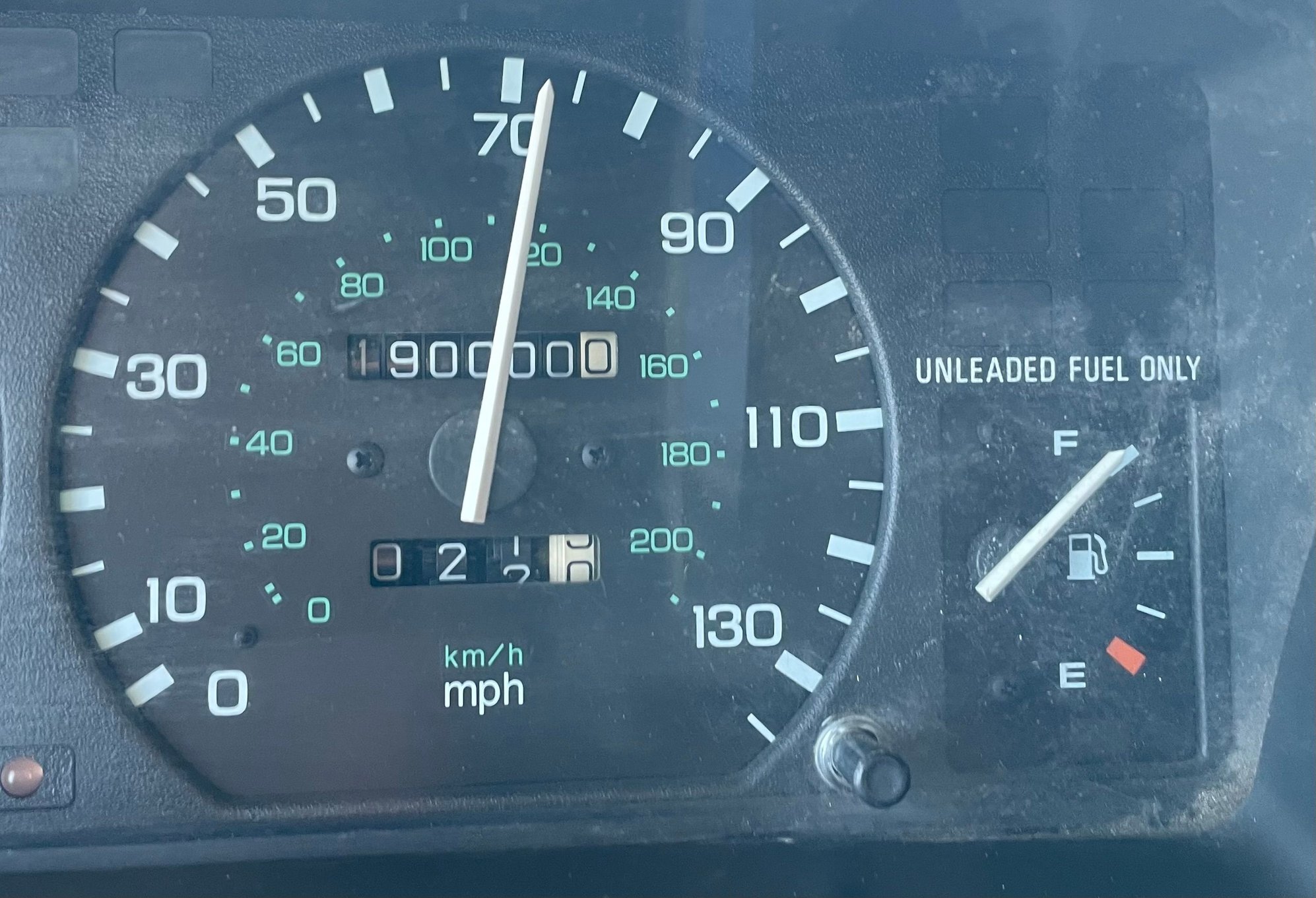

Default Hit 190k
Somewhere between Alpine and Marathon, Texas

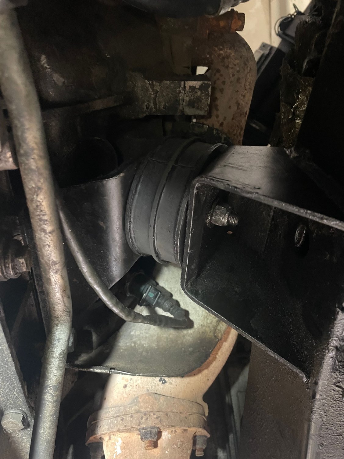

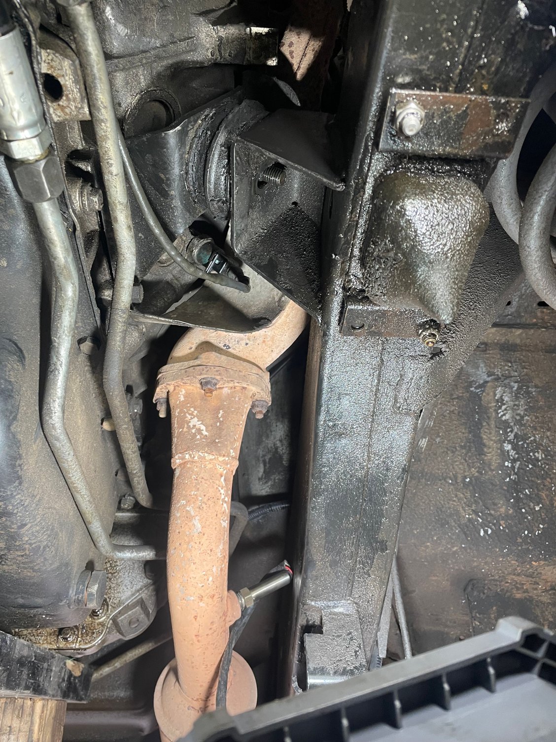

Replaced the front engine mounts. Went with the Jag XKE mounts. Easy in but a real PITA to get the old ones out. I now have much more clearance for the bank 1 sensor 1 O2 sensor. Gonna tackle the rear mounts ones some other time. They are in better shape than the front ones were.
I must say, it seems like I feel the engine more now. Most likely, I do since the old mounts were soft deteriorated rubber and the new are really firm. Still happy I got them replaced in my garage and not out on a trail.
CHEERS,
dcphotos
Old motor mount
Old motor mount, you can see O2 clearance was tight. I have this sensor almost backed out here.
New motor mount
New motor mount
O2 clearance
O2 clearance
