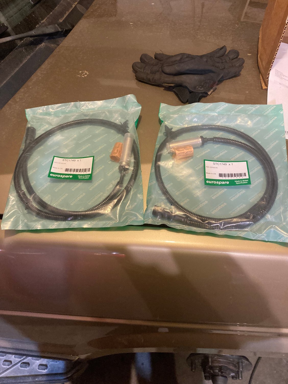

Worked on my '94. Solved the ABS problem.
Inexpensive ABS sensors with bushings

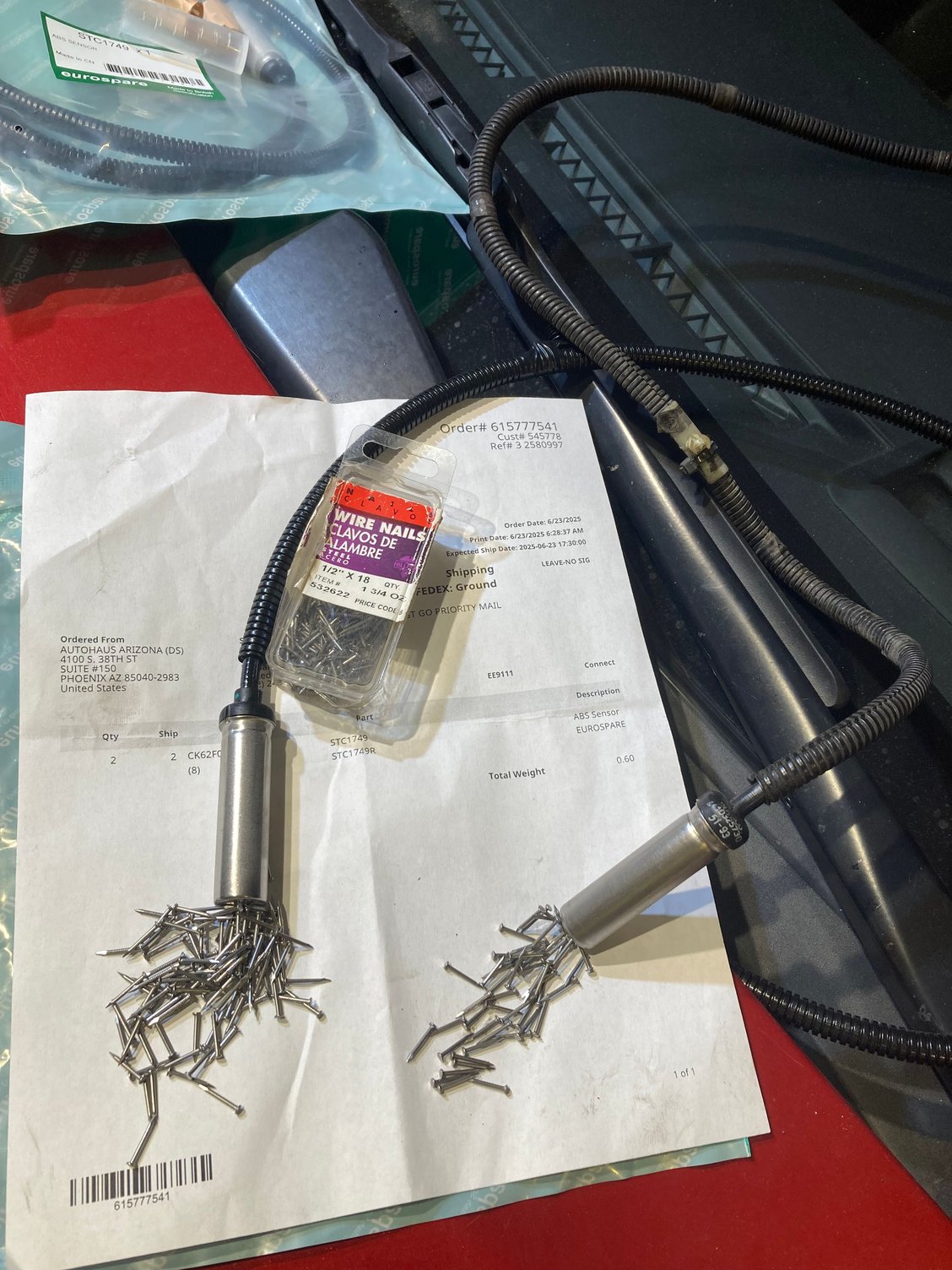

New magnet is much stronger
Solved the ABS warning light and heart-stopping-panic-when-it-doesn't-stop problem. Decided to do an experiment and replaced the front sensors with new (prices are very low at the moment from AutohauzAZ and FCP Euro). Got both sensors (see photo) with new bushings and new mounting plastic clips for less than $65 including tax and shipping.
I needed to adjust the position of the clips that are away from the sensors, but happy with quality overall. Also installed small wire ties at the first clips to help out the wimpy electrical tape. After reinstalling the ABS Pump fuse, the ABS Warning light extinguished right away on the test drive. No unwanted ABS during slow turns or figure eights. Good activation stopping on gravel roads.
Second photo shows my experiment. The new sensors magnets are much stronger than the old sensors and picked up significantly more test nails. So either the old sensors started out with weaker magnets (maybe not enough rare earth minerals), or they petered out as they aged (my theory, but too cheap to experiment until now). I'll let you know if the light re-appears or the heart-stopping-panic. For now I am happy! I did not replace the sensor bushings, by the way, simply out with the old, in with the new.

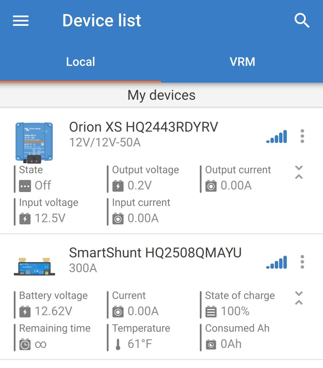

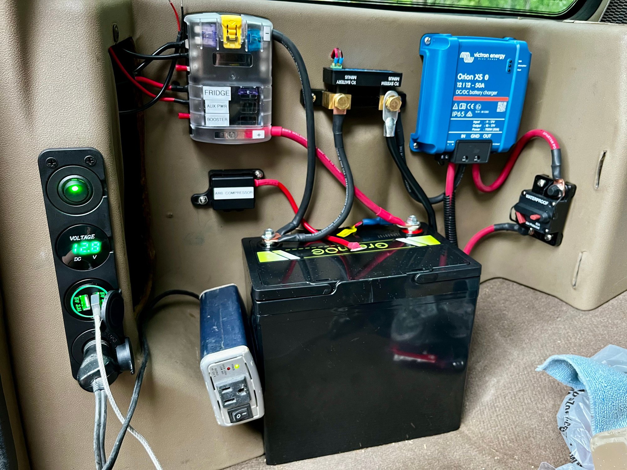

Been working on adding a LiFePo4 battery at the rear for accessory/auxiliary purposes. Learning as I go here but so far I do have power and haven’t burned down the truck yet! Bluetooth app to monitor battery status is pretty handy too.
Onboard air added now

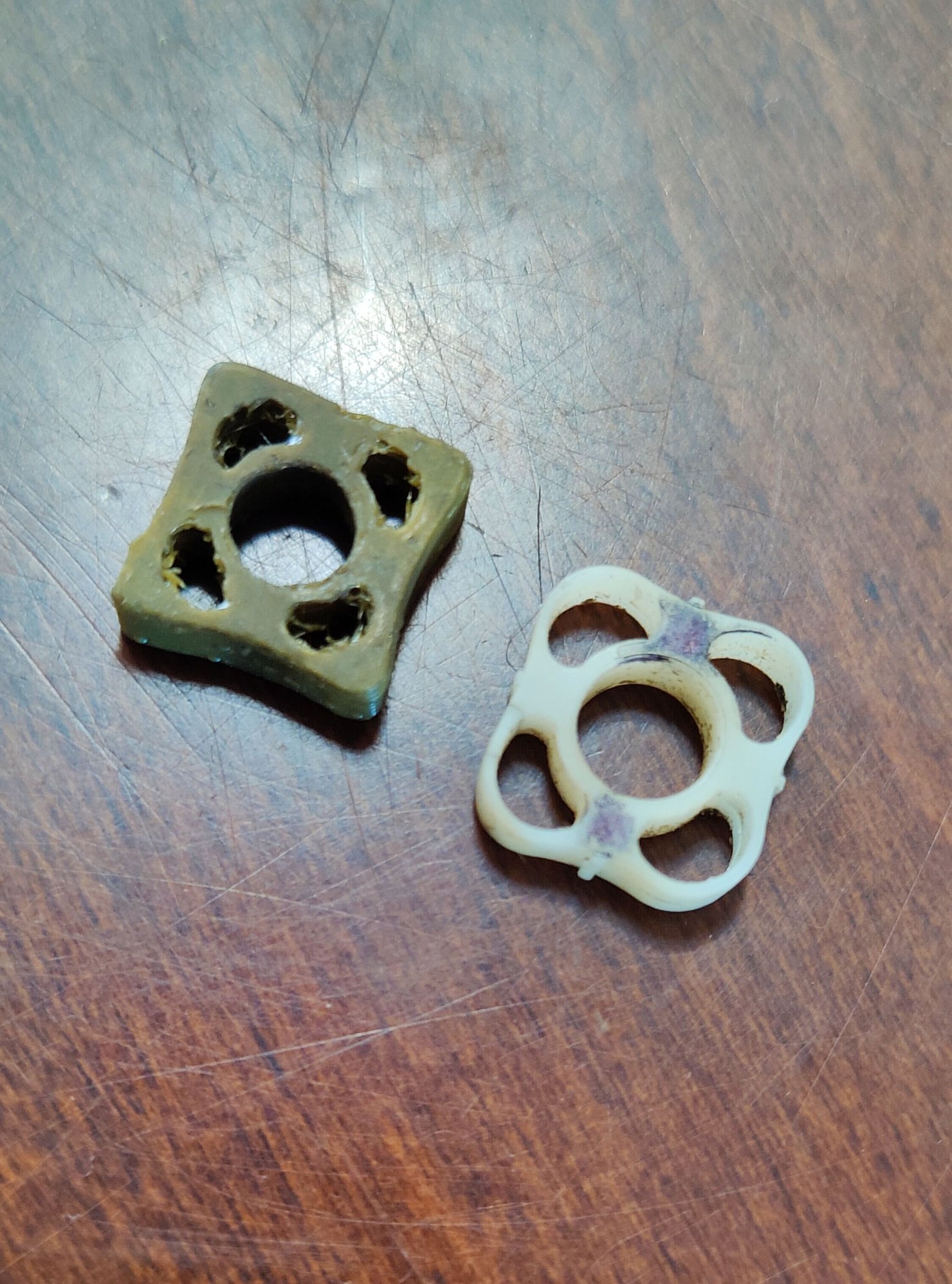

Finally got the 3d printing issues sorted out. So back at prototyping the parts for the sunroof.
Printing several, with smaller and larger openings, not sure how much that.atters ,also material type is another consideration. But I'm sure I'll have working sunroofs again.
