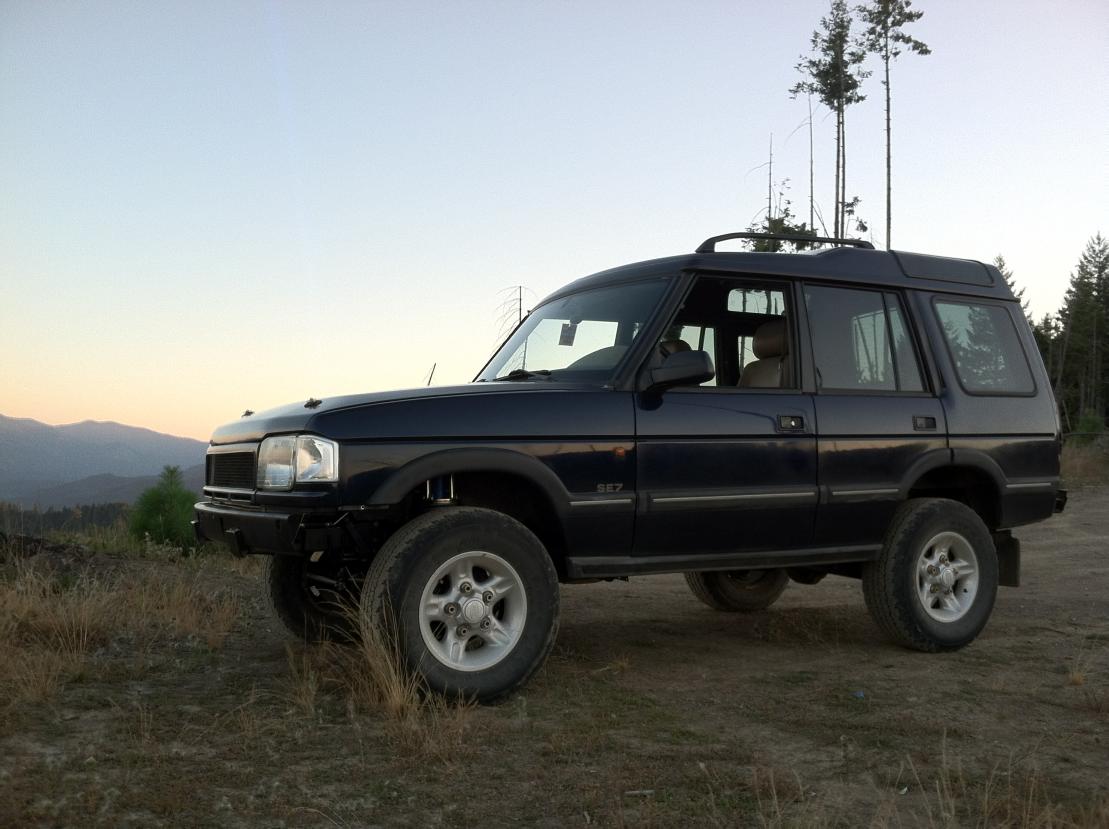

Finished installing Terrafirma +2" medium ProSport suspension kit, HD shock towers, securing rings, and stainless brake lines. Here it is on top of a mountain peak. We'll be up there again late tonight to watch the Perseid meteor shower, only accessible by Rover
bcbp, you only need one method, not both. Spring compressors can be a PITA, but are easier on the bushings. New shock towers and hardware are not required, though the kit comes with much hardware and I cleaned up the rest. By dislocate I mean they come out of the mounts before the shock bottoms out because they're shorter than stock. Maybe that's normal, maybe not. The rears are much easier. The shock is easier to get to, and the springs come out without any need for a bottle jack or spring compressor.

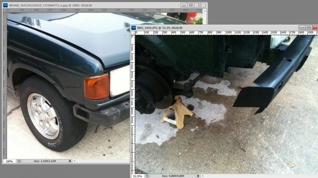

Only had about 30 minutes after work to till the rains started.
Got this done though....
Baby Steps I Guess...
