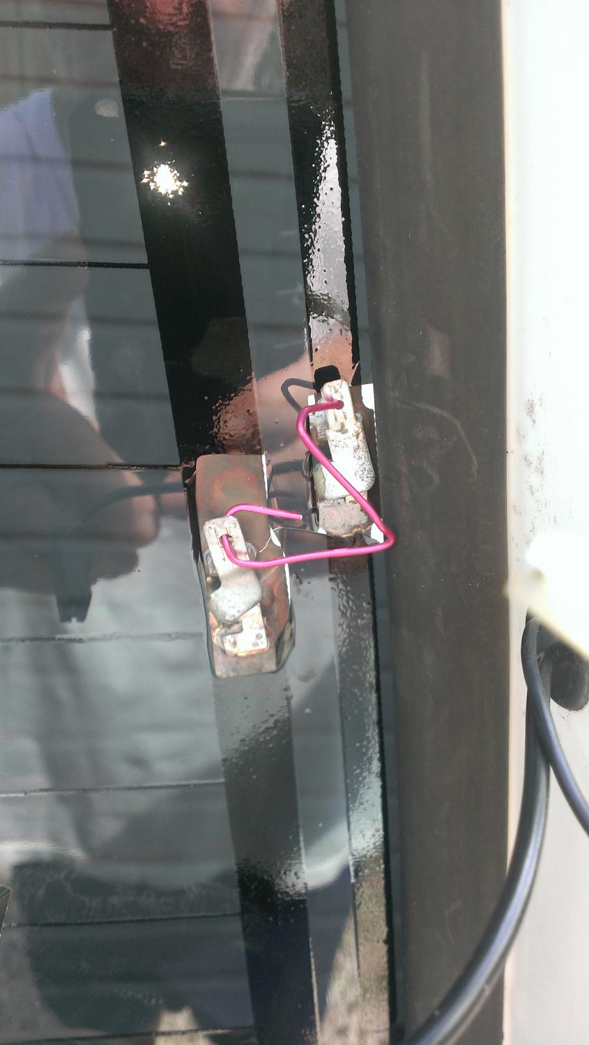

Is this is right? The 3rd brake light came on when I did this Pressed rear defrost and brake = nothing, still locked I have no brake lights Clues?
No that's not right.
A) If that's a paperclip there's paint on it preventing good contact.
B) You jumper the two terminals with the wires still attached.
Put the female connectors back on and jam the paperclip in there so its making contact. Turn the key to Pos II and press the rear defrost switch.
Also, it might not be your brake light switch that's bad. It could be the shiftlock solenoid that has failed.

I stripped off plastic from pclip got good connection w termials on turned on defrost button it turned orange so I know it came on key turned all the way before cranking and actually cranked it up too still same I hear the s'noid click when I press button on handle wonder if this could be fuse? nope all fuses good

Well the clip fix is not effecting it which is strange since my brake lights are not working
