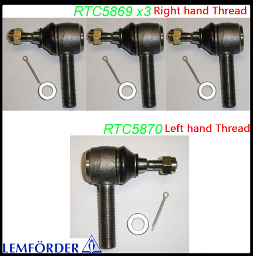

I have a D2 with Terrafirma track and drag bars they use RTC5870/RTC5890 the current ends are toast. What are the are best D1 ends ?

First a heads-up RTC5890 is a brake caliper and not a tie rod. The part number you need is RTC5869.
As for the brand I have only used LEMFORDER Tie Rods for years with spot on performance.
Here you go...…..

@OverRover thank you for the brand I was leaning towards LEMFORDER and sorry about the typo.

I have a Terrafirma bar in the front and and a Lemforder behind it with a Woodhead steering damper. The Lemforder is fine I guess, just a hollow tube so it's not the toughest thing. The bolts that came with it for the adjustment brackets are pathetic though, and bent when I tightened them down. I'll be buying all Terra next time, so incredibly tough and will never need replacing.
I've replaced all my balljoints with the following brands: Lemforder, Mevotech, Britpart. All are fine.

@ononomos I have terrafirma bars front and rear, but ends suck the boots lasted 1.5 years completely gone. I want something will last tad longer
