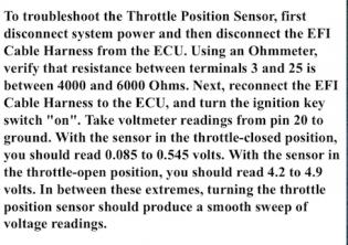

I am not sure where the author got this, but I found this on an ebay ad selling a Throttle Position Sensor.
I am just starting to learn about electrical, so it sounds greek to me, but if anyone carries out the test, I would love to hear about the procedure.

That's great but there are 3 plugs on the ecu and I do not recall the pins being #
Keep hoping someone will chime in with the section in the rave since I do not seem to be good at navagating the manuals. ; )
I have found the rave electrical manual to be very difficult to navigate.
When you say three plugs, are you referring to the actual sensor? I understood it that all the testing was being done at another location, closer to the main ECU component. But I have not dug in.
I am going to try this weekend and see what I find.
