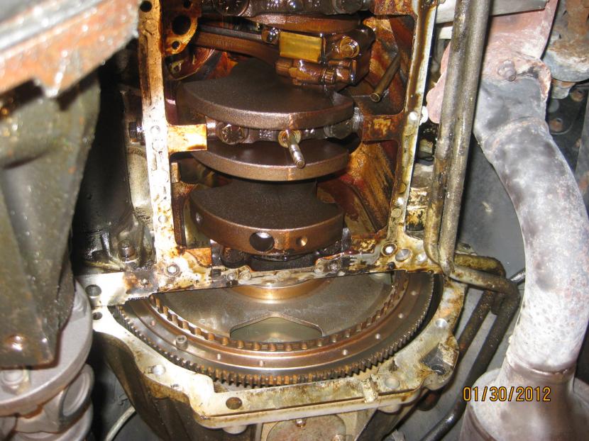

ET - in the pix, the outer ring with teeth is what the starter engages (you know dat, but newbi might not). The inner ring with the milled gaps is what the CKP uses to make the signal. When you had the block out to go to the shop, was this removed and perhaps not put back in alignment? It has a gap in those teeth that provides the sync to the ECU. There are 60 of these "teeth" and they are 6 degrees apart. There is a missing gap that lines up with 60 degrees before top dead center of cylinder number 1.

Hmmm... The hub aligner is dowel located on the crank shaft so that can't be misaligned, but I can't remember or find if the ring gear is also dowel located on the hub aligner. Since there are 4 bolts securing the ring gear to hub aligner, it could be off 90 degrees. To check, I could move cyl 1 to TDC and I guess the gap should be 10 tabs before the CKP. If it really is off 90 degrees then maybe these are the symptoms? Really don't want to take the engine out again...
if you were 90 degrees off my guess would be the engine wouldnt run well, if at all.
it uses that missing tooth to determine the ignition timing as everything is based off of degrees away from TDC.
i would start looking at the sensor mounting, the sensor condition, the wiring/sheilding conditon to the sensor, sensor mounting, etc... and ideally (if you can get your hands on one) throw an o-scope on the sensor output to see the waveform. this will be the bottom line. if it scopes out ok, then youve got something else going on (which could include issues with the VR conditioning circuit in the ECU itself...)
my guess is that it wont look very smooth though, and that your issue is related to the sensor. also check sensor gap, or see if for some reason its sitting too far away from the trigger wheel - ive seen this happen if the sensor is oring sealed and the wrong oring is used or the oring moves during install.
im assuming (without having looked at it) that its a 2 wire sensor
the waveform will look like the one on the right of that picture... with a long "gap" where the missing tooth is.
the ecu uses the 0 volt crossing point to determine the tooth position. if the signal is noisy or inverted, the 0 crossing occurs at the wrong position... which will confuse the rate of change function that is monitoring tooth position to determine misfires.
