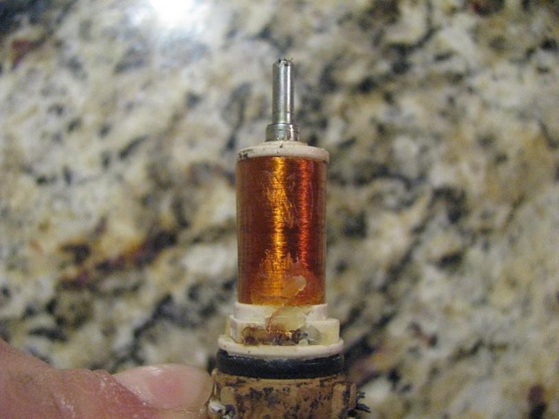

Here's what the Lucas one looks like inside.
Hard to tell what was wrong. The wires are very small.

That wasn't the Lucas I was talking about (Lucas Oil Treatment) lol -
But your pix shows two things. First, the tip can't be bent or covered with metal filings (your's is not). Second, being a coil of small wire, it is soldered or connected somewhere to larger wires. If solder joint is "cold" you would have erratic performance that would be heat related. If a mechanical joint, then temperature could expand that as well. A solder joint is also subject to cracking under vibration and stress. Another fun thing with fine wire is that it is actually insulated with a coating, like varnish; and such material has to be stripped away in the fabrication process to solder the wire, etc. If the wire supplier changes, the thickness of that insulation can change, and equipment set to automatically handle thickness "X" may not do well with thickness "Y". That assumes these are not hand fabricated, but instead made thousands at a time by machines built to do this.
Could you read the resistance of this coil with your meter and post that? I wonder if it changes if you tap on the unit, etc. A momentary open, or a partial short would change the performance of the pickup coil.
