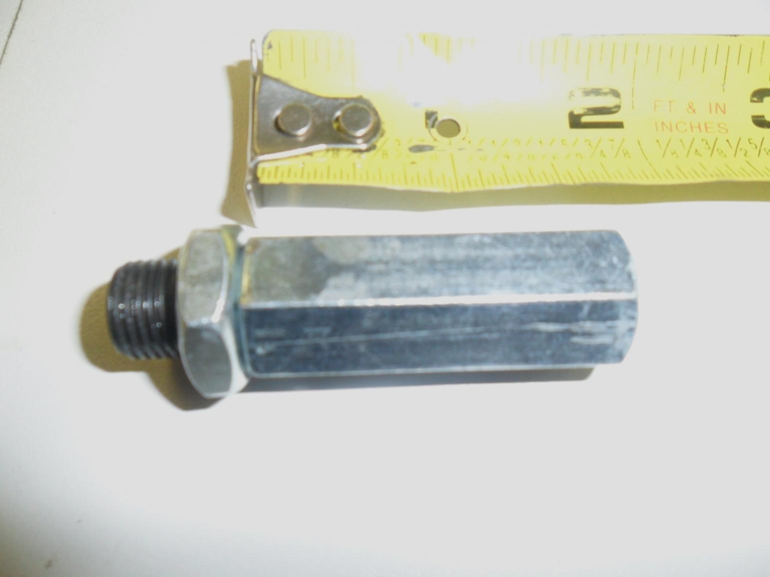

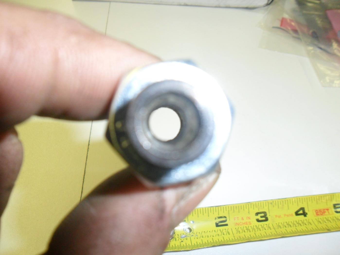

I had a damaged cat,( from misfires caused by a soaked computer issue last winter) kept getting P0430. I purchased an "O2 spacer" from O2 Spacer - CEL / MIL Fix - O2 Sensor Spacer - Oxygen Sensor Spacer - 02 Spacer ....which pulls the sensor out of the exhaust stream to simulate a cat that's ok instead of one that apparently has a little extra "flow". It's been a little over 2000 miles and no more P0430...so far so good (knocking on wood here !) they sold me a pair of them for about $50.00.
now that I have one...there's no rocket science here....everything is threaded 12MM -1.25, thread this into the O2 sensor hole and thread the sensor into this. (behind the cat)
At this point I have left the "good" side alone. If you have a bad cat , or are going catless this may help with the cel until you decide to install new ones. (yeah, I know)
