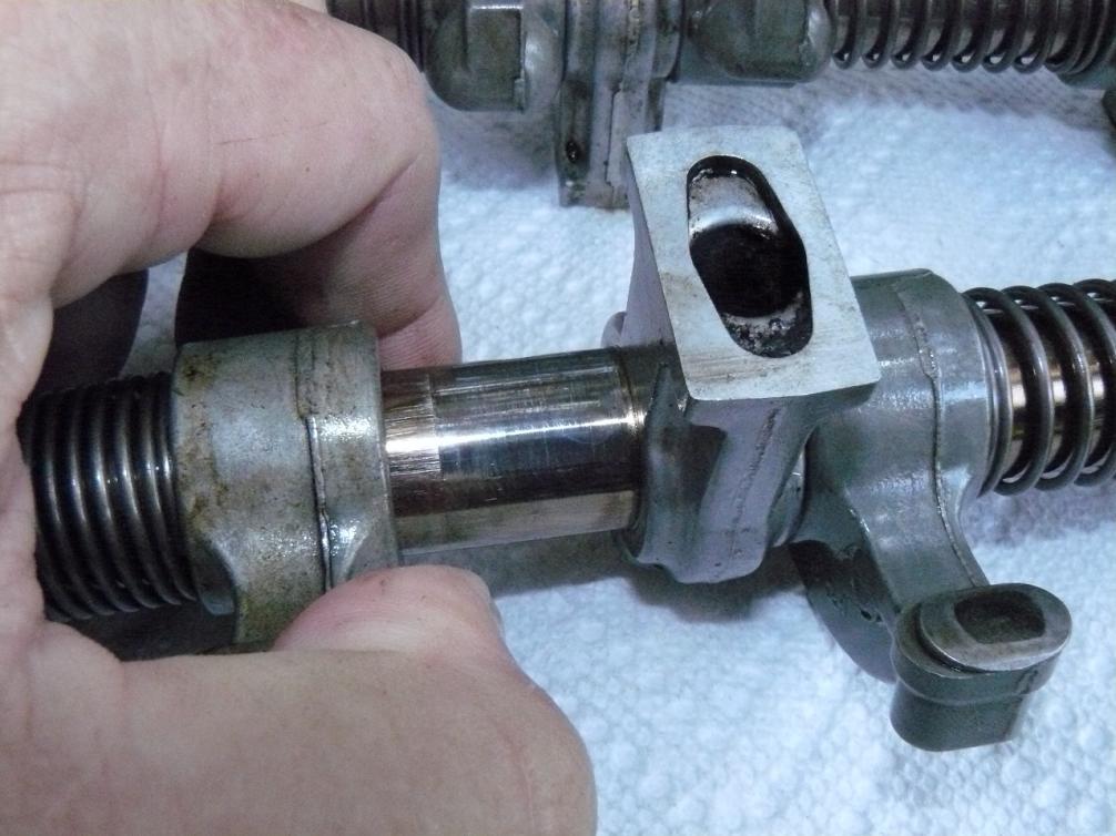

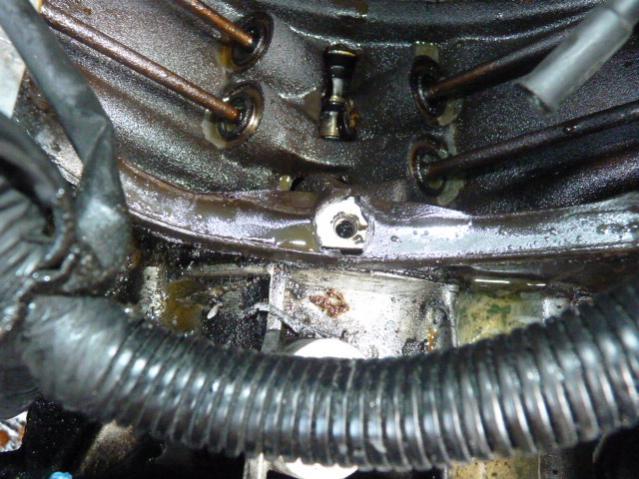

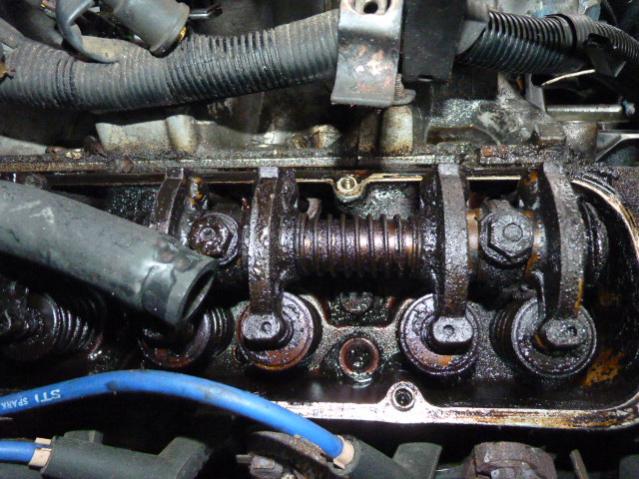

Attached Thumbnails What to look for-99 Disco 1-rad-crud.jpg   What to look for-99 Disco 1-p1120320.jpg   What to look for-99 Disco 1-p1130087.jpg   What to look for-99 Disco 1-p1130118.jpg   What to look for-99 Disco 1-p1050978.jpg

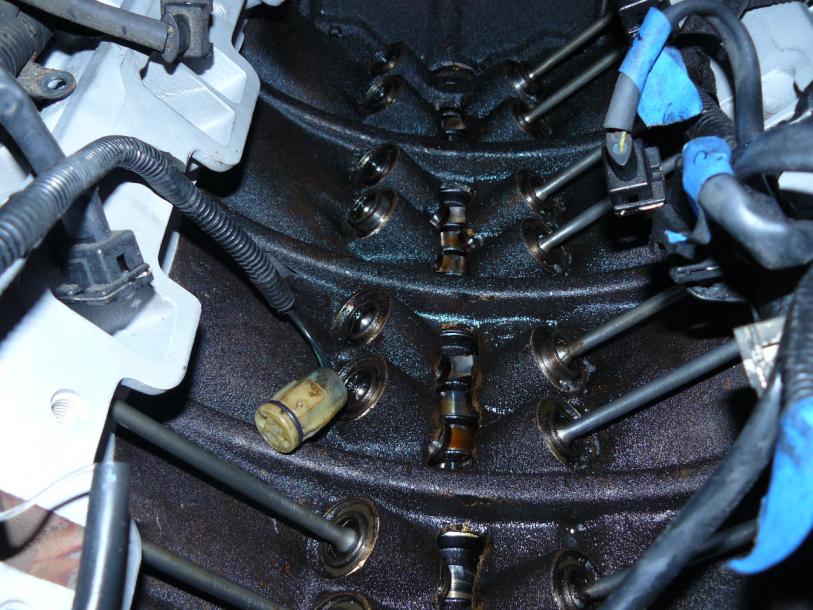

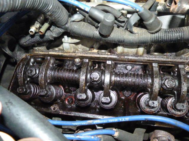

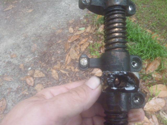

Attached Thumbnails What to look for-99 Disco 1-p1050979.jpg   What to look for-99 Disco 1-p1050982.jpg   What to look for-99 Disco 1-p1050999.jpg

Unless you are in cold country the 15W40 is just fine. If engine is sludged, like mine, Rotella will reduce some of it, but the baked on stuff will remain. I've been running Rotella for two years, also have put in Marvel Mystery Oil, and BG flush product. Solvents can't reverse all the gunk. As an example, inside the valve covers, oil is pumped up one tower, moves down the rocker pipe, and is squirted out each rocker arm to the rod that presses on the lifters. So most of what you see is splash and spray lubrication.
