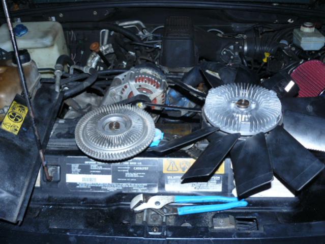

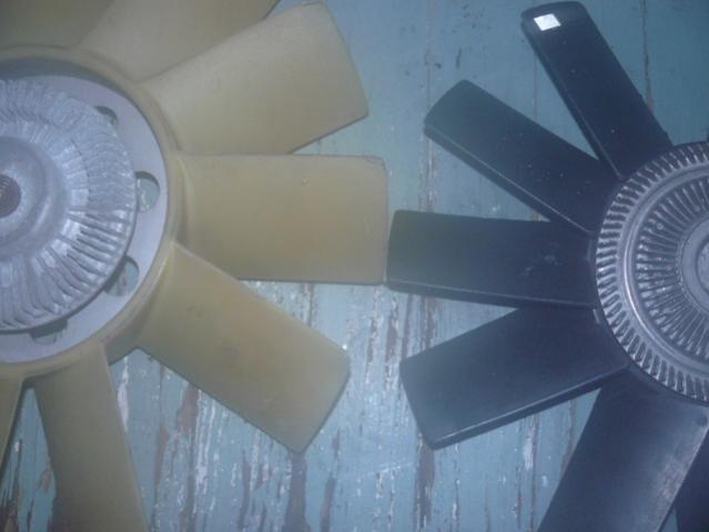

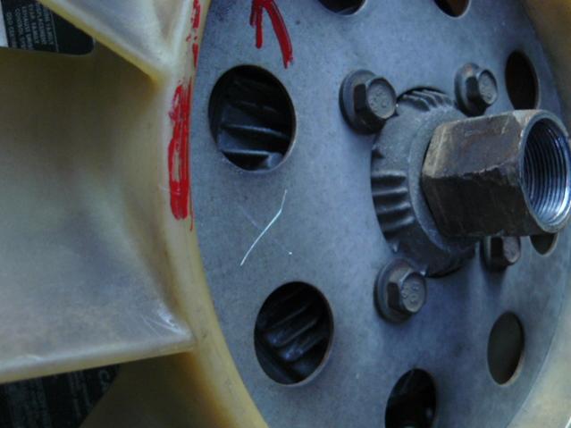

2000 ish Blazer. Want the style with metal hub. Similar era GM trucks may also have a black nylon fan. Will fit with no fan shroud, does not cool as well without shroud, so use in emergency only. Nylon back rumored to split.
On the white nylon, blades can be trimmed carefully and no splinters, sand edges, even seal to prevent fraying. Have had this on for around a year. Found at salvage yard, flew in low with partz vulturez and snagged clutcgh and fan for $19. Clamp on part of shroud removed for photo.

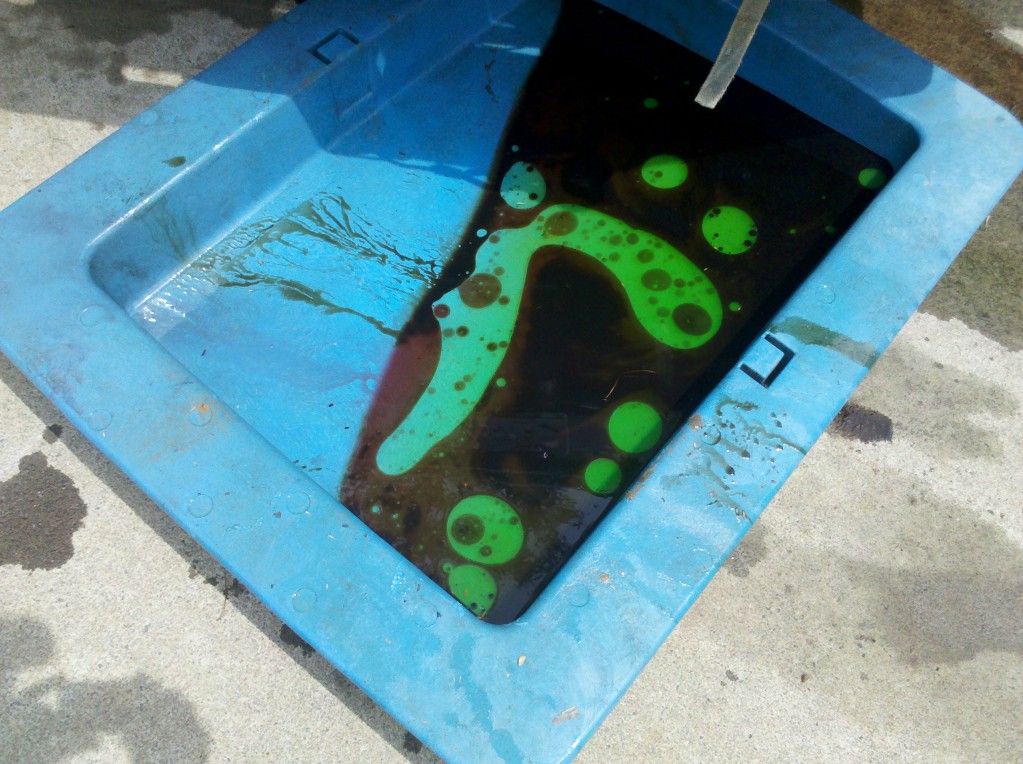

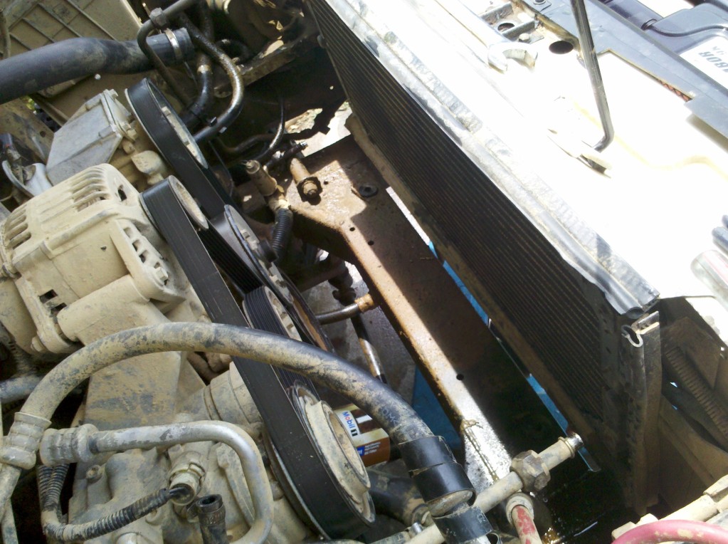

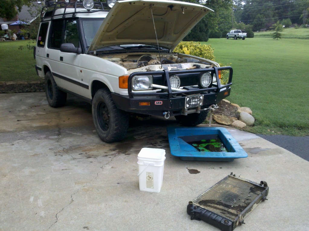

Here's some pictures of some nasty fluids from taking everything out the other day.

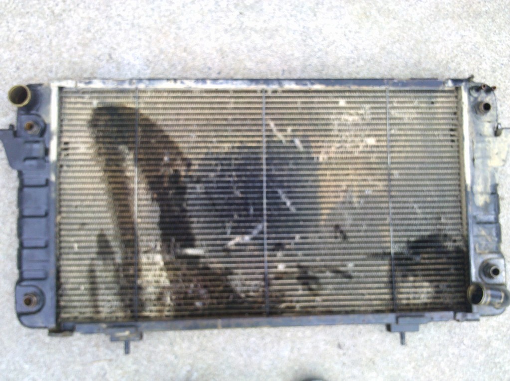

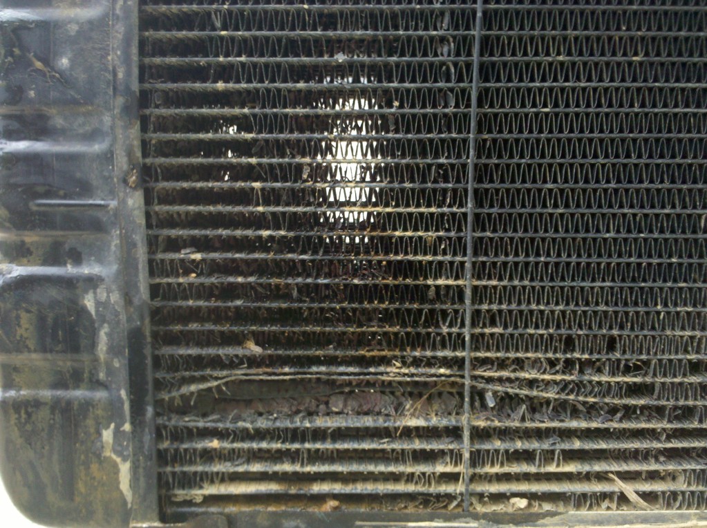

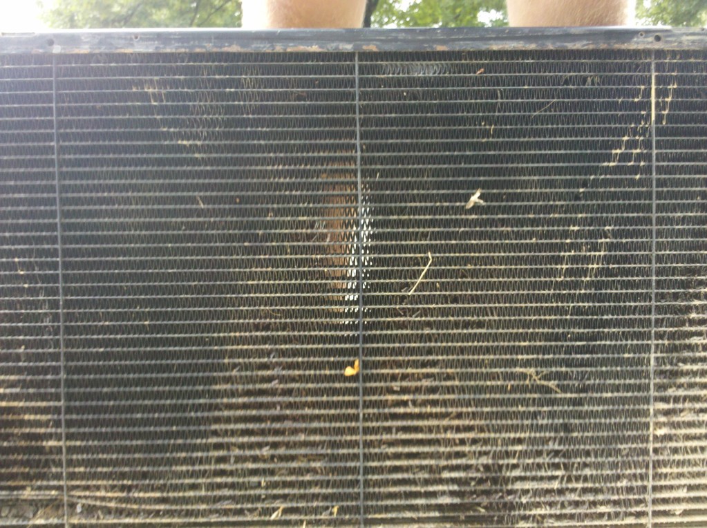

So can we all assume radiator? Quite a few of the bits of metal gone, but is that enough to run hot?
Yum. Name:  IMG_20120804_121835.jpg

did all that brown fluid come out with it. if so you have a blown head gasket. that is a lot of oil in your rad fluid. you can see the separation between the watery antifreeze and the the oil in the pan. hopefully that is just trany fluid in there.
