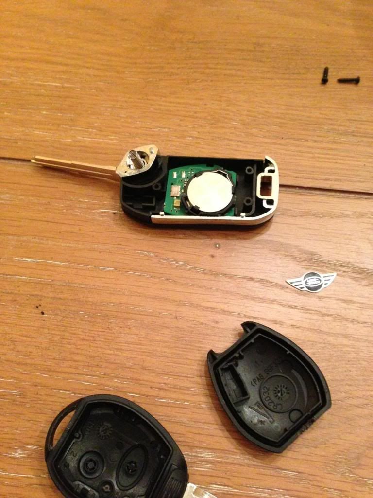

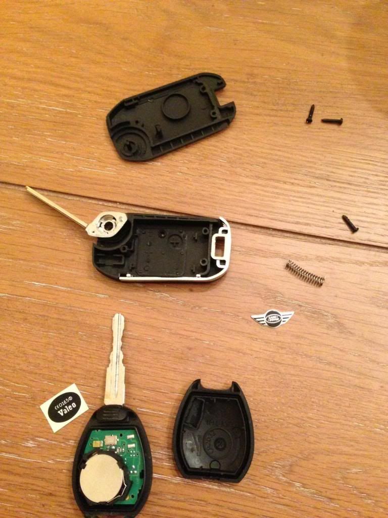

Got mine, easy breezy:
The trick is to just rotate the top part one full revolution while connected to the spring and then push the whole thing together. That'll create enough tension to spring the key out like a switch blade
