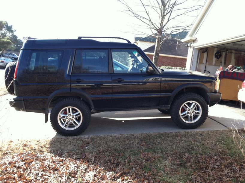

Terrafirma makes a 2in lift for D2, I decided to give them a try. kit comes with springs and 2in longer shocks at all four corners, install was super easy but do consider that longer brake lines and sensor extentions are going to be needed for off road antics.
