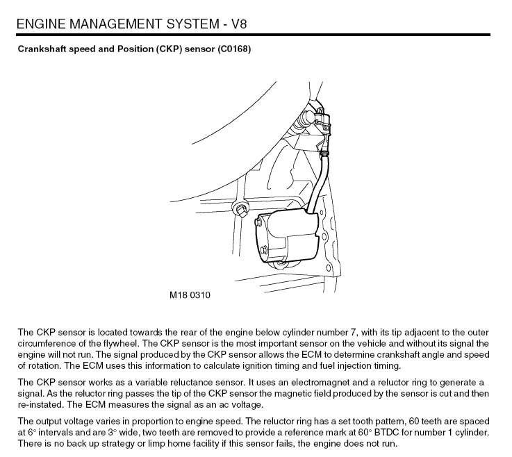

x2. Best part is that it's super easy install. Unplug, unscrew and reverse to install. Drivers side halfway up. Easily reachable from underneath the truck. The attached diagram is a funny angle but should get you where you need to be. Your local parts store will have this in stock. Good luck dude.

Attached Thumbnails 2000 discovery quits running without warning-image.jpeg   2000 discovery quits running without warning-image.png
