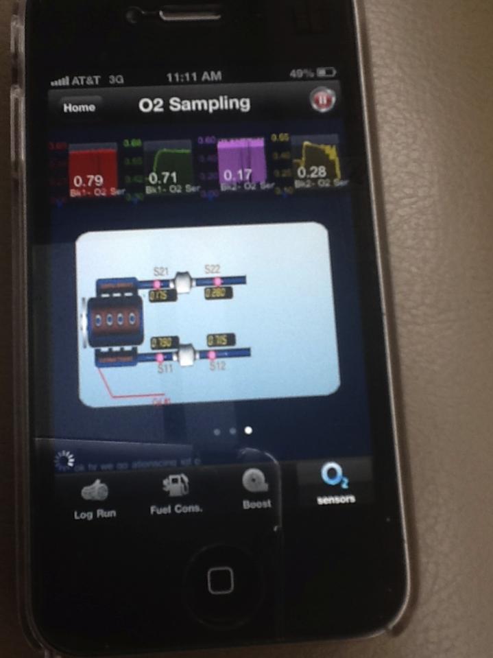

I use the ELM327 (white one)and the Laplogger app on the iPhone or iPad if i want to check what the OBD has to tell me.
I am able to get running info...temp, o2 sensors, speed, rpm, and other stuff that I don't look at.
I did not want to be a nervous nelly, constantly needing to know if I am running at 202 or 205 degrees. I check it to see my number once a week or so...All good.
Gives you the engine codes too.
Slick little unit.
