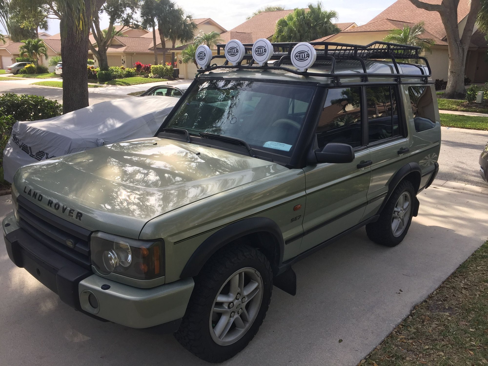

Starting or not, that is a good looking Disco 2!

Wow, she is VERY nice! Hope you get the starting issue fixed. Sounds like bad ground or loose/corroded connection.....
