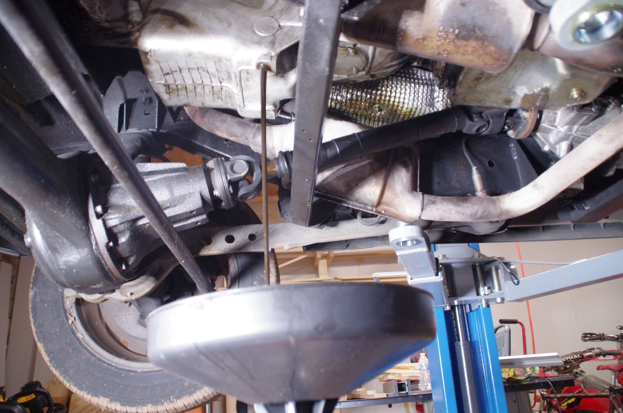

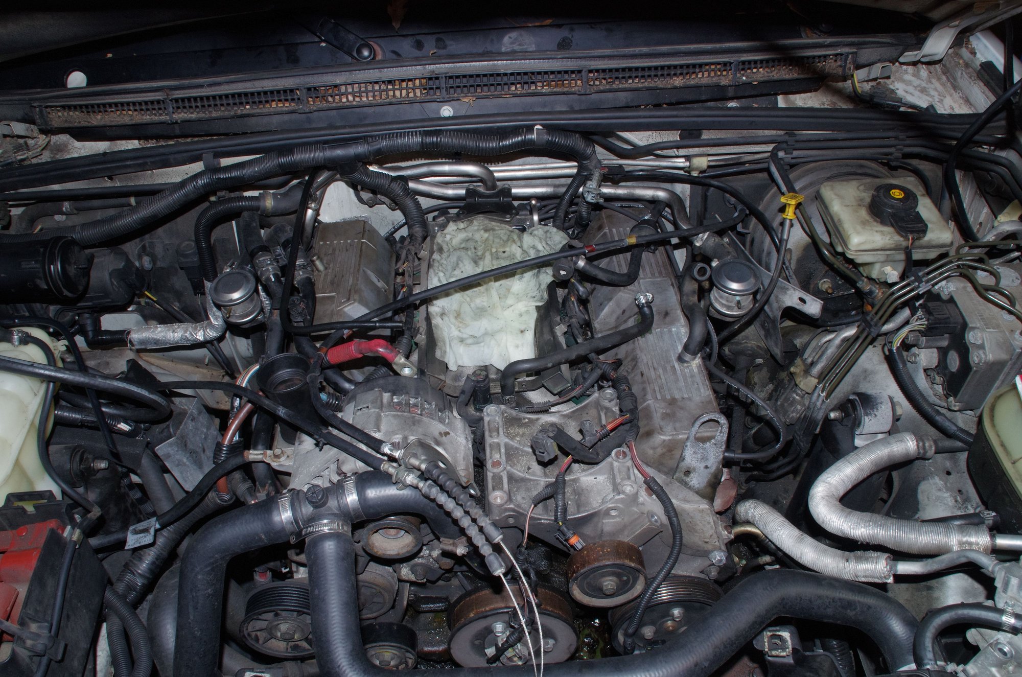

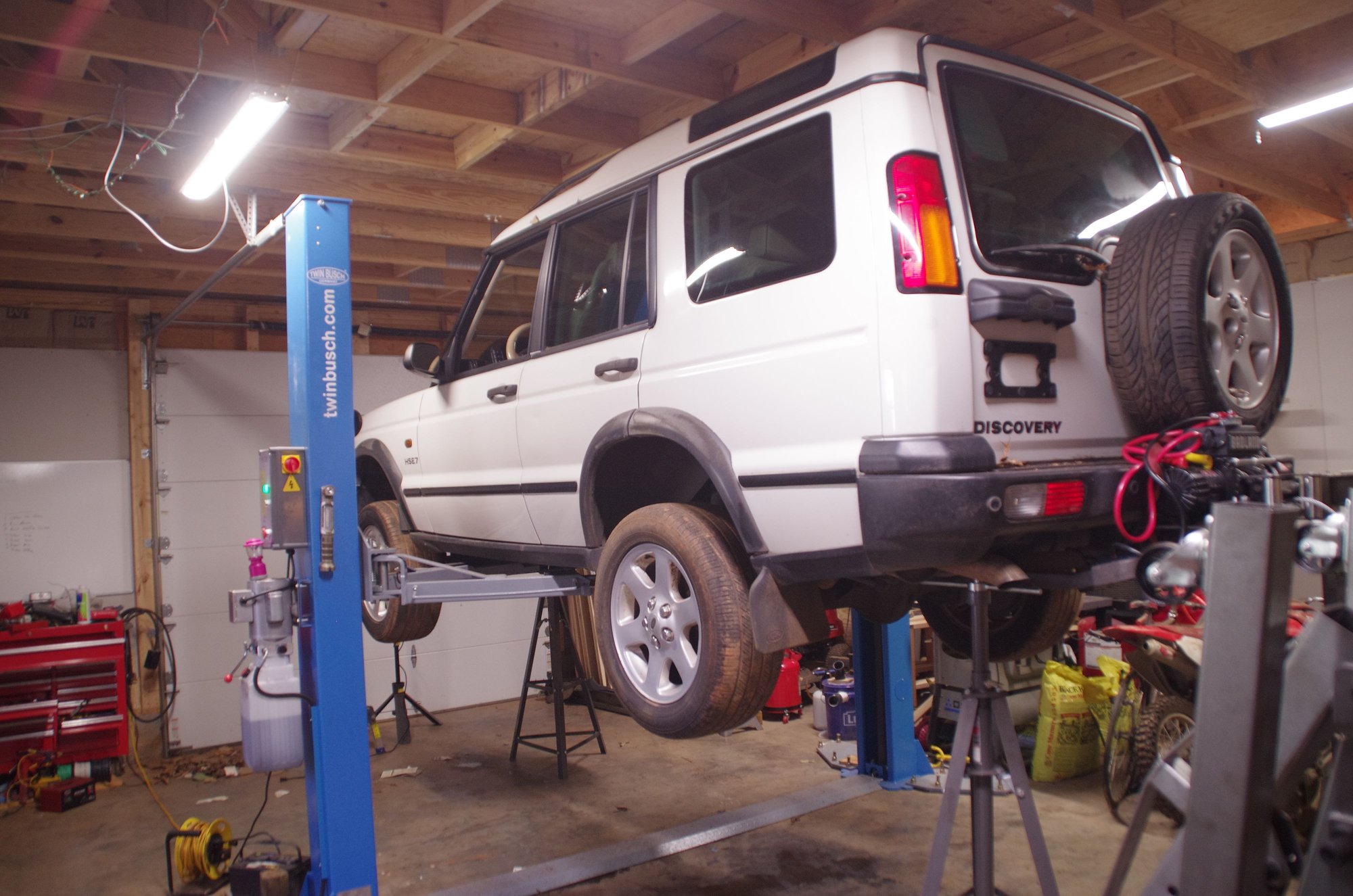

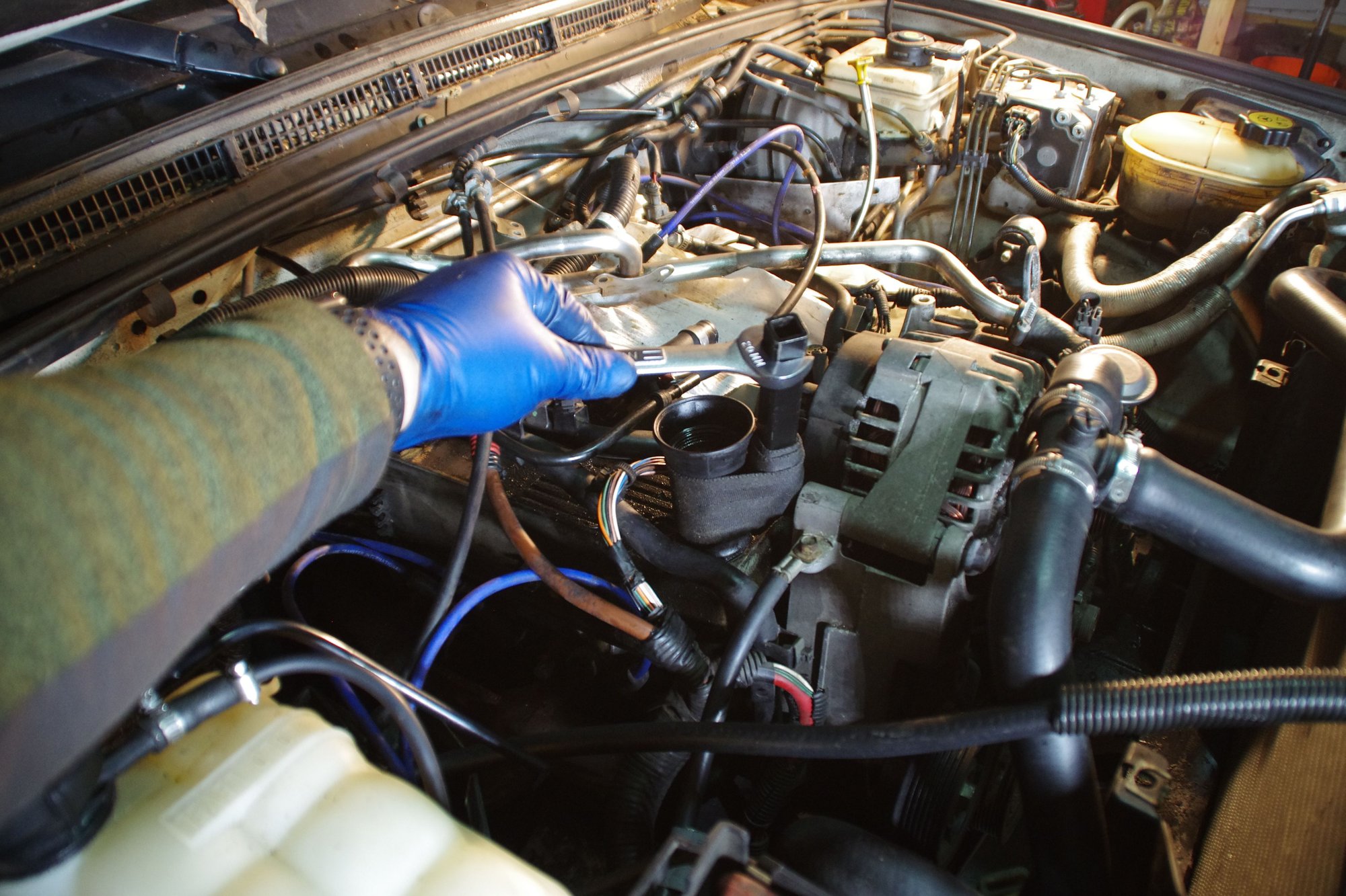

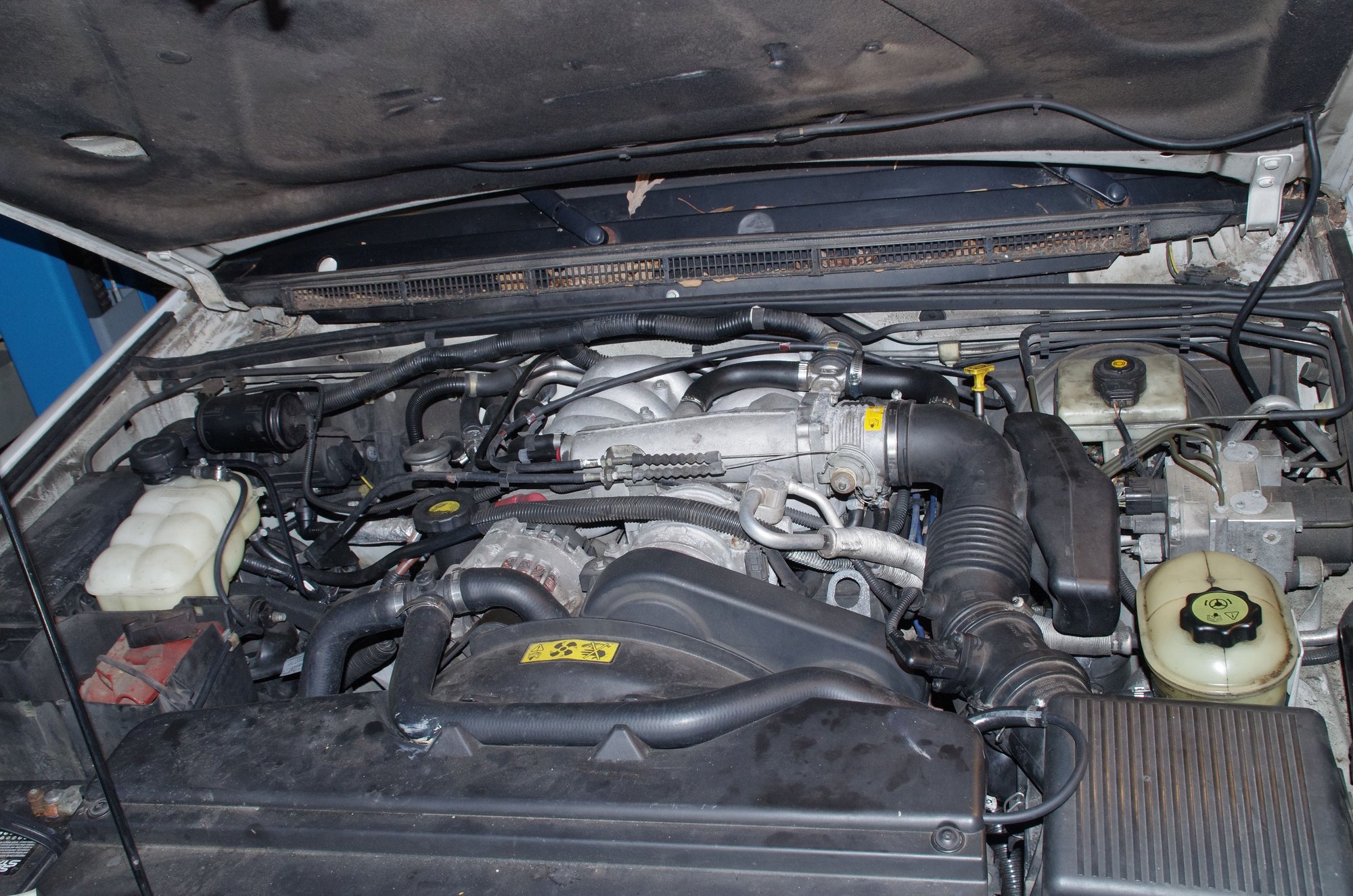

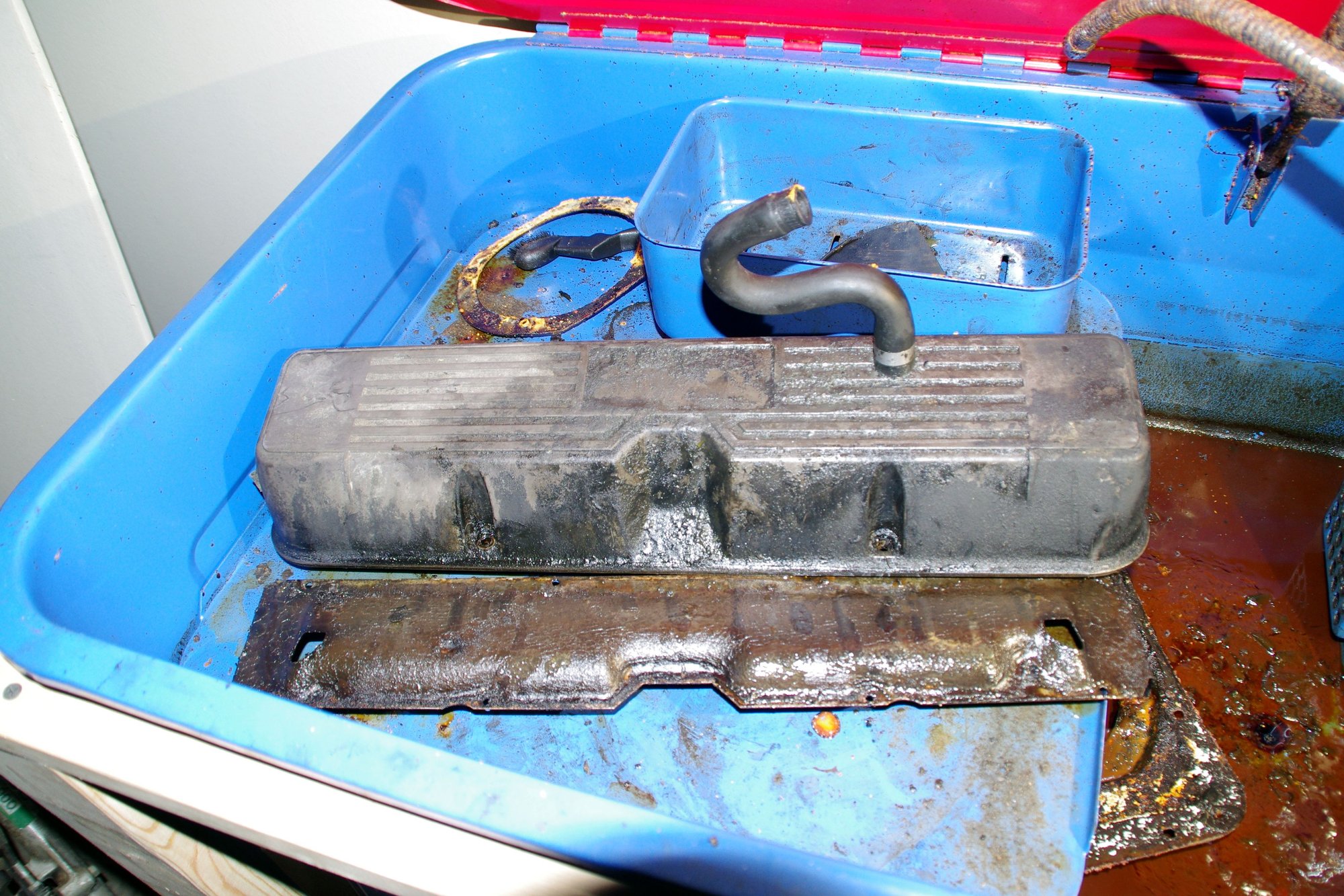

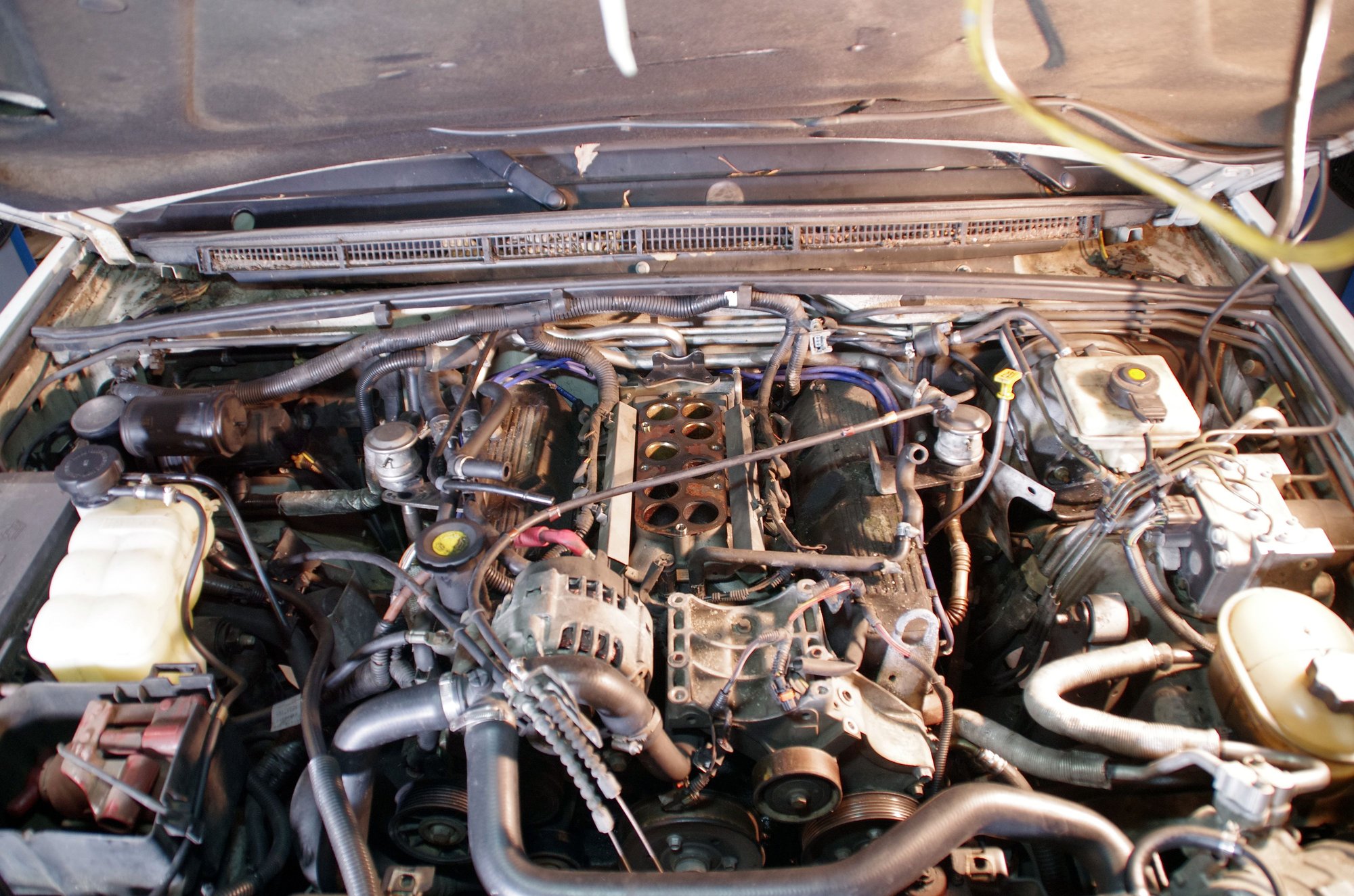

Received the parts I had ordered, went ahead and replaced the Plugs, wires and coil pack. Not the easiest task on a LR, I get why the coil pack relocation kit exists. Long story short, my issue remains unchanged. With new O2 sensors, plugs, wires and coil pack. All in all the parts and cleaning were needed on this truck, a bit disappointing to spend all that time and effort to no avail.
Start of project
Up on the lift
draining the oil, diff's, transmission and transfer case.

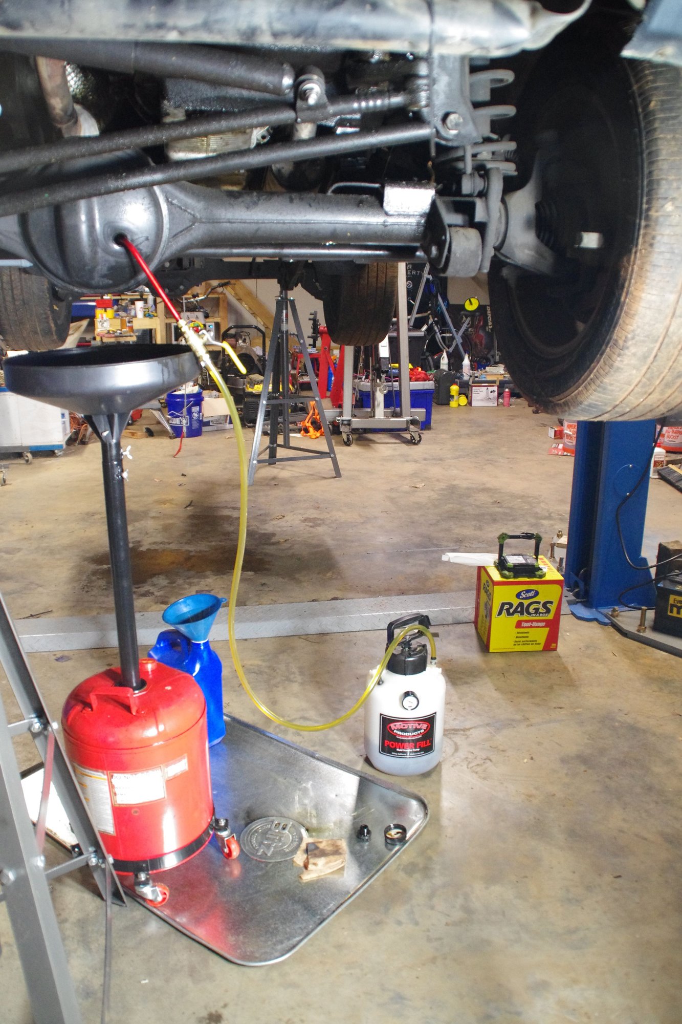

Putting fluids back in.
Intake is removed

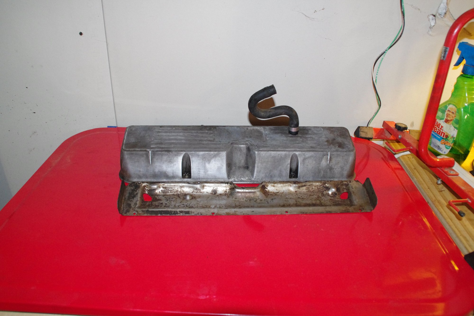

Time to clean some of these parts.
A bit cleaner
Some of the parts were just frozen in place due to dirt / grease. Got it off and cleaned.

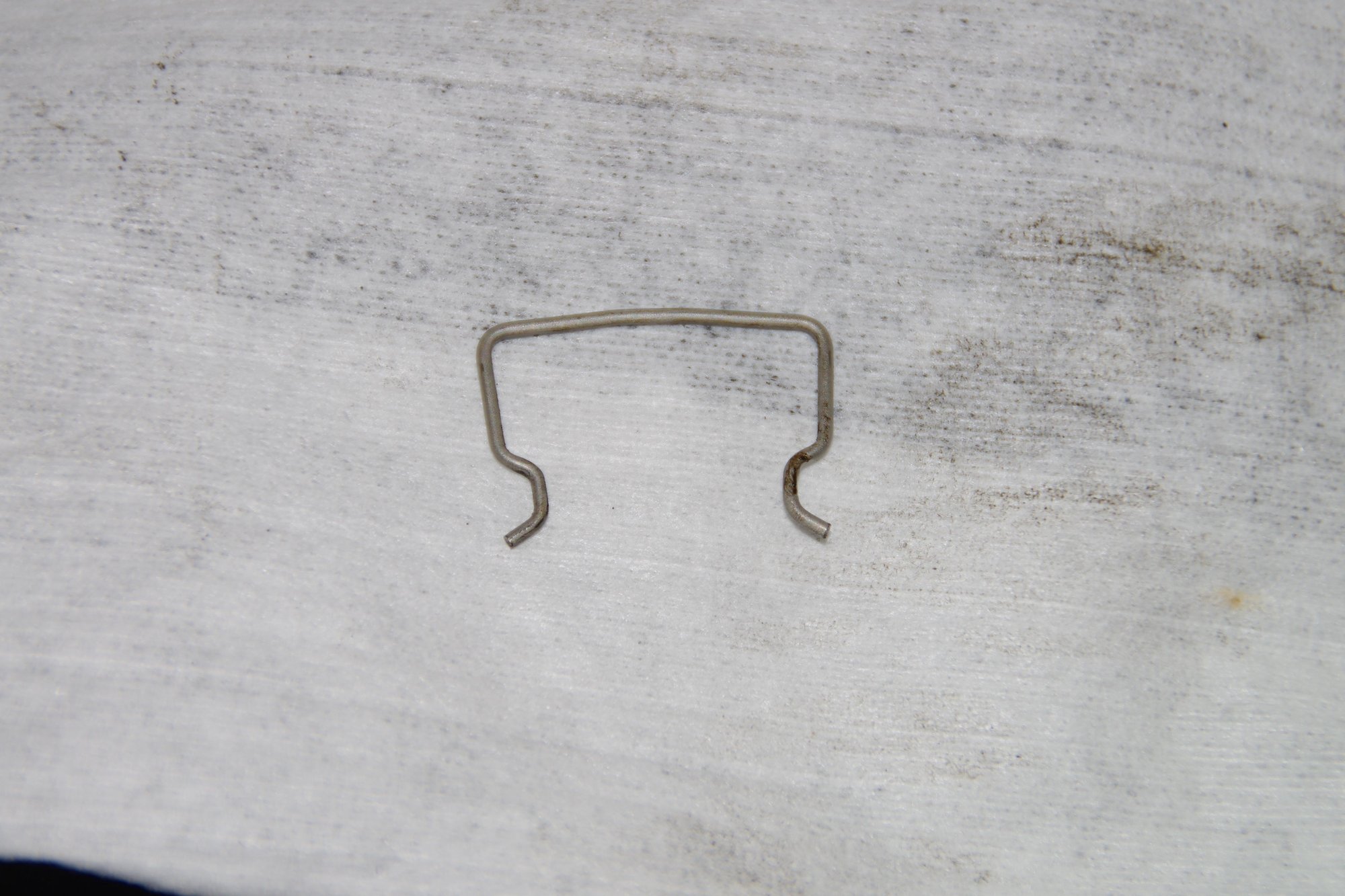

Anyone know where I can get these clips replaced? I lost one of them.
Rovers North?

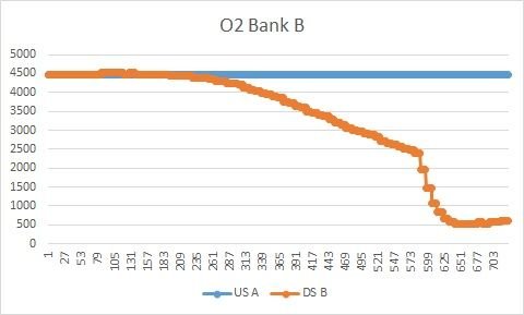

Because it will only run for ~5 min, then shut off. It will take a bit of time to get both sets of 02 sensors graphed. Here is Bank A upstream and downstream.
  • FoxWell NT520Pro
  • Live data exported to excel and plotted.
  • the scale is missing a decimal. 4.85 - 4.45V
    • This bank neither 02 seems to be working properly.

Here is the other O2 bank. It would seem the Down stream O2 is working and the Upstream is not. Maybe I will stick the Upstream O2 from bank A into Bank B and see if this works.
