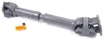

Number one item.
* Stop driving it. Then, remove and replace the front prop shaft w/ a unit that has grease fittings.
This free advice could potentially save you 7k in repairs and a bitch of a headache. Welcome to the wonderful world of Land Rover.

This one has a Grease Fitting on both ends. Greased it all up. Should there be any other worries about the shaft

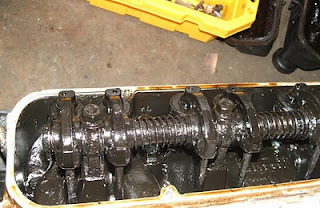

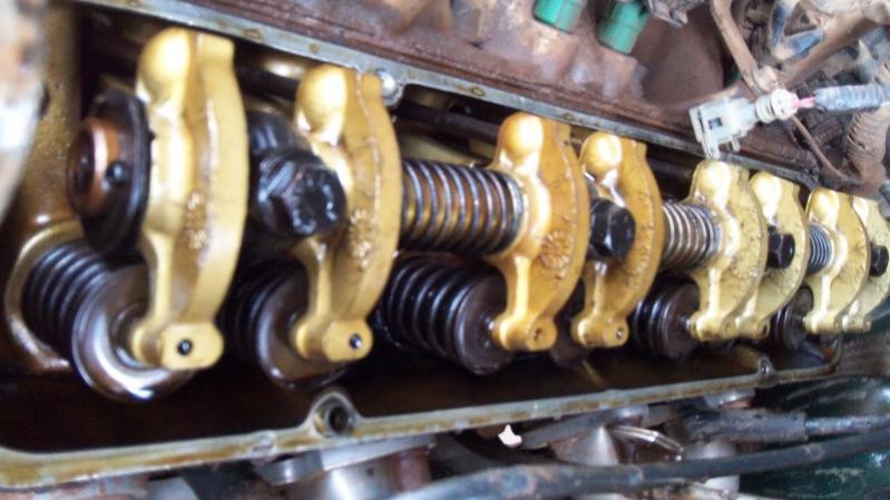

see https://landroverforums.com/forum/di...estions-46975/ The jumbo filter, in Purolator/MANN, or WIX, or Baldwin gives extra oil capacity. Shell Rotella oil, 15W40. Change every 5000. The use of the diesel rated oil is to get extra cleaning formula. These engines have plenty of sludge building properties, like easy to clog PCV system seldom cleaned by previous owners. Pix of engine at 190K with Rotella use (switched from Castrol), good drain intervals; and one that maintained on a less strict schedule.
Does it look like this one? Note: It has FOUR grease fittings respectively, for each U-Joint. Maybe another one located for the centering ball. If not, I'd replace it.
