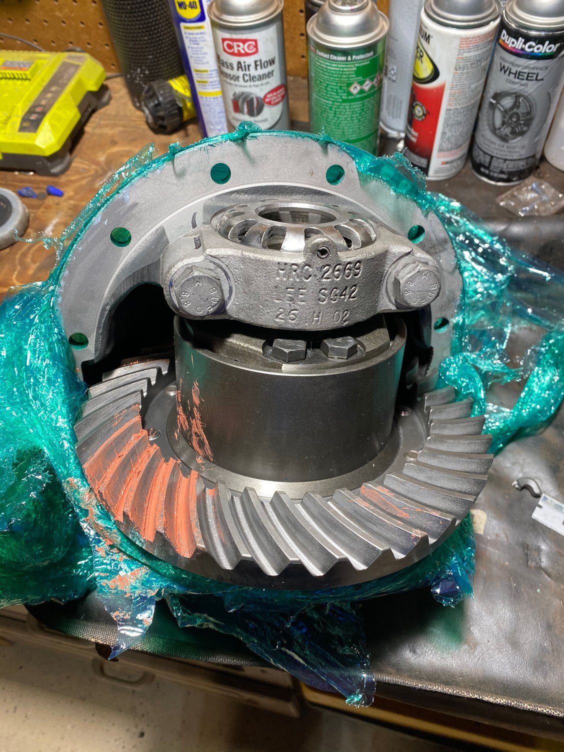

Finally got diffs w/ truetracs from GBR. Couldn’t wait so I had to open one. Gotta admit - I,be never unscrewed a package before!
Going to attempt the rear diff this weekend and see how it goes. Planning on using this write up. https://landroverforums.com/forum/di...nt-rear-78876/
Diffs came in pails. Genius!
Unbox - err unscrewing
Beautiful!

So do you run those new differentials without traction control or with?
Old Mar 18, 2021 | 07:54 PM
  #386
cvhyatt's Avatar
Joined: Feb 2019
Posts: 1,222
Likes: 595
From: Jacksonville, FL
These will run with the traction control. Using a lower gear ratio (4.11) with Detroit TrueTrac. Good write up here: Coil Sprung - Differential Carriers | GBR Utah
