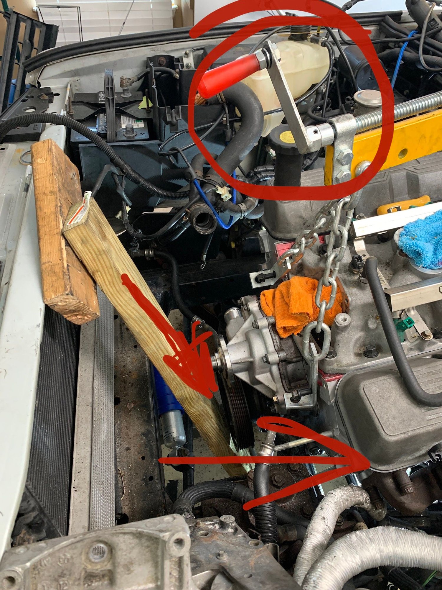

Been working on getting the engine lined up with the transmission off and on. I am a one man show except for my 11 year old son so its been difficult to say the least. So I decided to take a break while I thought about how I could simultaneously push the engine forward, lower it and line it up. Quite honestly I had been avoiding it for a couple of weeks and then my new bumper came in from Dark Crow Designs which gave me the extra motivation I needed to figure this out. The solution ended up being a simple one. I wedged a 2x4 at an angle in front of the truck and as the engine was lowered, it pushed itself forward. Load leveler helped me position it perfectly. So glad this is behind me!
Now where did I put those bell housing bolts? ��
New bumper from Dark Crow Designs.
My way of man handling the engine in place.
Near perfect alignment!

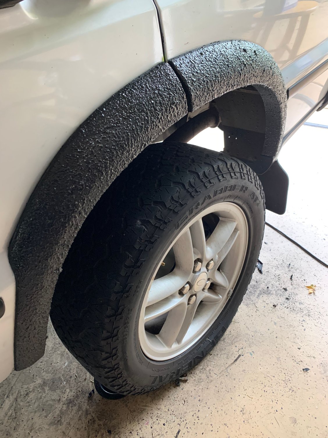

Got 10 bolts in plus the flex plate to engine bolts. Got 4 more to go then will do the engine mounts. Took a break and painted the bumpers with Durabak. Can’t wait to get these things mounted!!
Prepping for paint
Final coat
Close up of the surface

I like it! I will warn you though, Durabak fades bad in the sun in just about 4 months. If you spray some good clear coat on it now it'll last at least a couple years before fading, makes it clean better too. I figure you want it to stay black and look well.
Old Aug 11, 2019 | 08:25 AM
  #75
cvhyatt's Avatar
Joined: Feb 2019
Posts: 1,222
Likes: 595
From: Jacksonville, FL
Thanks for the tip! I added the UV inhibitor to the batch so hopefully that will help. Florida sun is brutal.

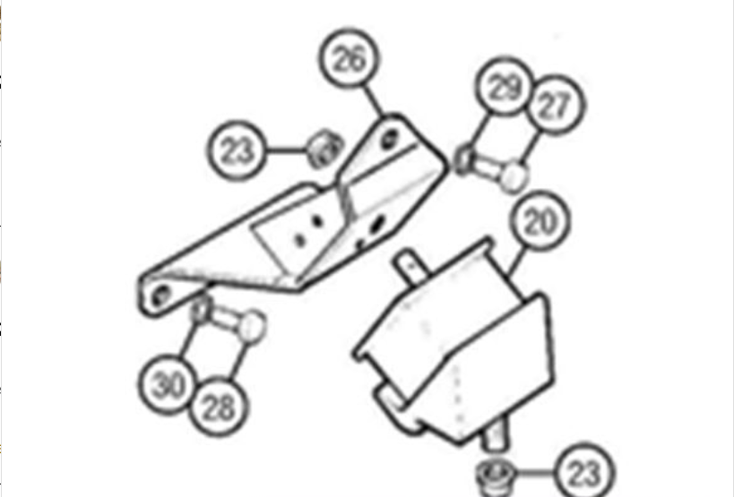

This thing is kicking my @ss. Got the engine in and hooked up the exhaust. All but 4 of the transmission to engine bolts are in. I went to put in the engine mounts but found out the manifold on the driver side gets in the way of the top engine mount bolt. To make matters worse, I mislabeled my bolts for the engine mounts. I figure I need to loosen the manifold in order to put the engine mount in. Anyone know the proper size for the top engine mount bolt?
Got close to throwing wrenches and decided to take a break and use up the rest of the durabak.
Anyone have an idea about what bolt size goes in here?

Still working on getting the engine mounts in place. Because I stuck the engine in with exhaust headers, I have little room to work with to bolt this thing up. Lost the bolts somewhere in the frame. $&%#*#&*!! Found a good diagram on RImmerBros which shows the bolt size so it is off to home depot to see what I can find.
