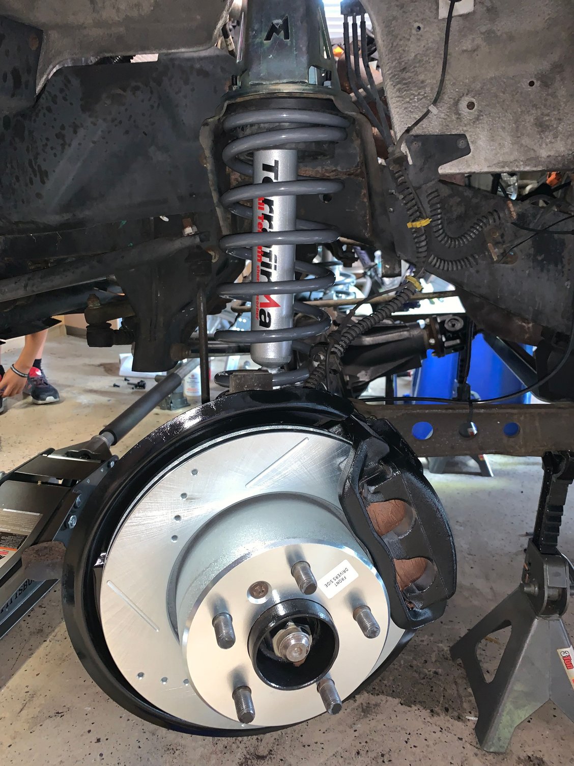

Default 5/13 Update
Still no progress on the engine yet but I did finally finish the 2 inch lift, new coils, springs, shock towers, rotors and brake pads. Will start engine work tomorrow.
Is is it just me or do I now need to buy bigger tires? 😜
Final assembly
Puny tire!
