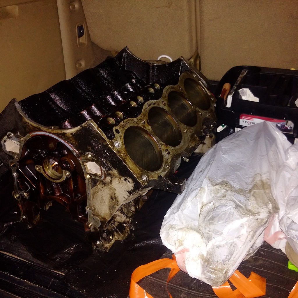

Default Finally to the Shop
Got everything off (but left the rocker assemblies on the heads, finger tight) and ready for the shop in the morning.
Uneducated view of things: crank bearings have visible grooves but corresponding crank portions look good. Probably just polish. Rod bearings looked good and smooth. Nothing looked copper colored. Sleeves were even.
I bagged and tagged each cap with its bearings and each piston with its bearings.

man, that is one caked up lump
For sure. I'm glad I didn't just put head gaskets on! Hopefully, the after shot will be much better.
