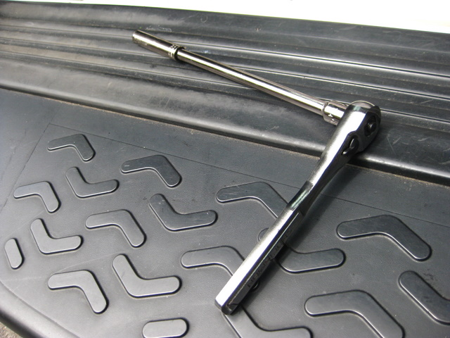

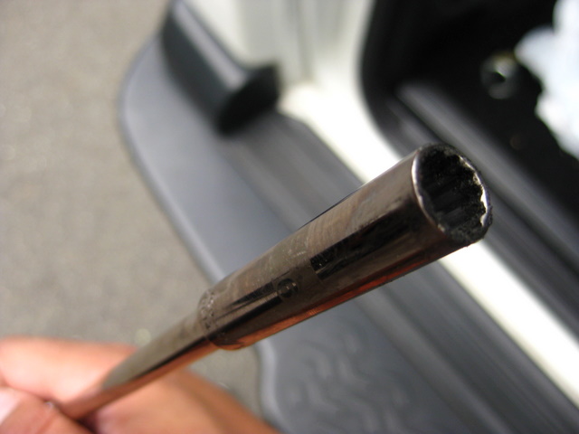

Just an update: The 5/16 in. 12pt. deep socket (1/4" drive) worked perfectly:
Here it is with a 6" extension on the 1/4" drive ratchet

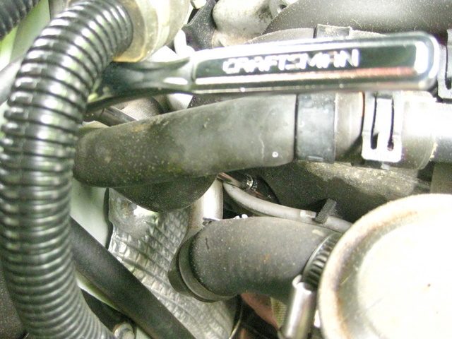

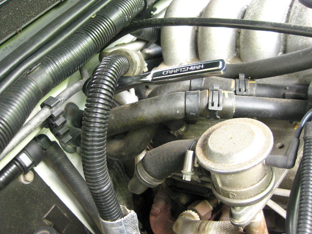

If you go with a shallow socket, get an extension longer than 6" - the right/passenger side back bolt (near the #8 cylinder) was tough to get to because of hoses (as you can see here, I had to do a little "dance" to get her in):
then went behind the spark plug wires/leads as well:
I thought the used car dealer tightened them up as I asked, but they didn't - I had to turn at least 180-degrees and then a smidge to tighten properly.
