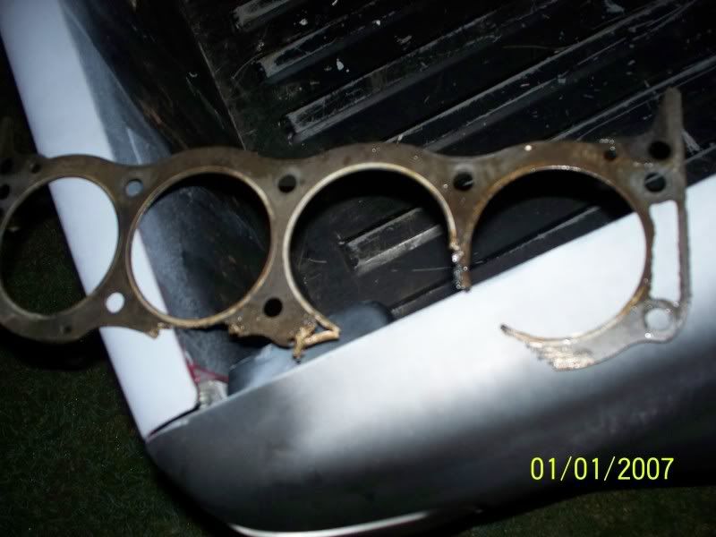

I've never seen nor heard of a head gasket blowing this bad. I had it running for 5 seconds, turned it off and started tearing it down. Yes it was that bad. The only real diagnosing I done involved a peice of paper gued to a stick. Here is the reason why http://i38.photobucket.com/albums/e1...ork/HGonLR.jpg

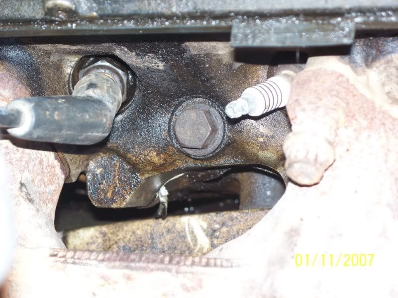

And when I tore it down, here is one everyone will love.
http://i38.photobucket.com/albums/e1...rk/HGonLR2.jpg
okdiscoguy, your wrong. On this one anyway, it's a normal iron block.
I do work on any vehicles, besides Nissan's which I work at a Nissan dealer and don't want to think about them after work. The guy already know's I can't gurantee ANYTHING. I found 2 broke drillbits and metal shavings ontop of the intake gasket/tray. One plug was half way cross threaded. He just wants the absolute bare essiantals for it to run, not even wanting anything cleaned. The head IS warped but within spec, gave him advice and he said no. Once it runs after the head gasket job and I get payed I will never see that poor POS again.
