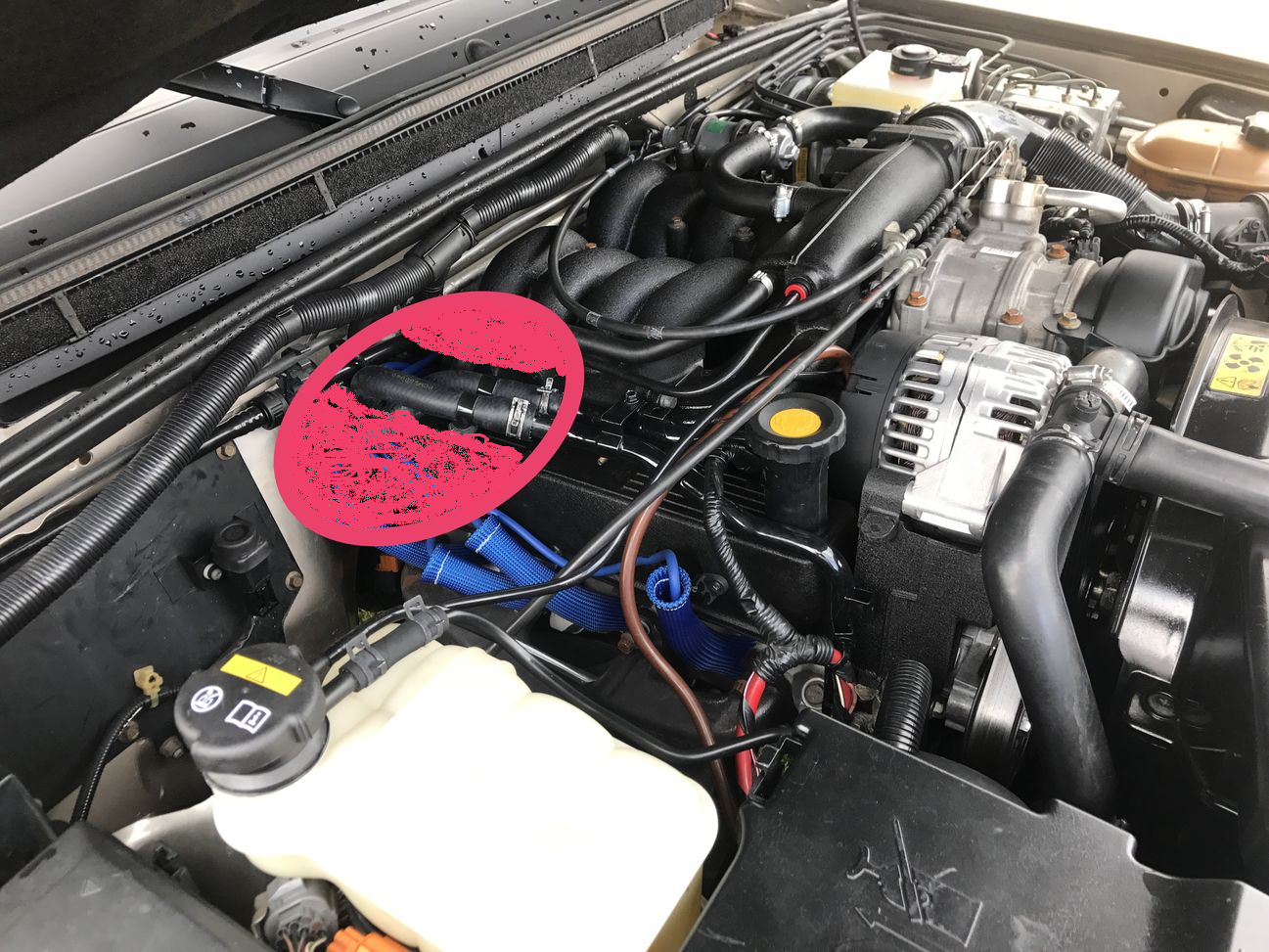

If my daughter had that problem, I'd suggest that she buy 2 vice grips from WalMart and use them to clamp shut the two black rubber hoses that go from the motor to inside the cockpit (to the heater core there) when the motor was turned off and cold.
If for whatever reason hot radiator fluid was erroneously circulating through those 2 hoses when it wasn't supposed to be circulating, closing off those two hoses for a quick test would have the A/C blowing cold again on an otherwise properly running Disco 2.
So clamping those 2 hoses should tell you if the problem is in the temperature control system or with the A/C.
Those hoses are shown inside the red area if your Disco motor looks like this picture.

Coolant is always flowing thru the heater core. The only thing that prevents the heat from going thru the cabin at anytime is the flap for the heater core. If it's stuck for some reason then yes you'd have hot air mixing with the cold air from the AC (it does this actually all the time in AUTO) when the system is maintaining a set temp.
Basic AC 101 if the compressor isn't engaging/disengaging = the AC is not working.
