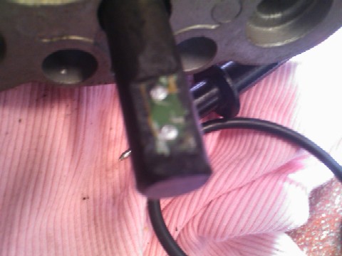

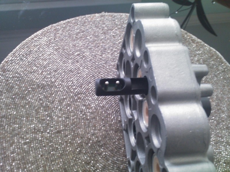

Last weekend I pulled a friends TD5 ABS module apart to fix the " 3 little buggers". The module already had a new shuttle valve switch in it, but it failed to fight the little buggers off!!!.......
so it HAD to be a dry joint somewhere in there. Dug away and found one of the pins had a dry joint, re-soldered both, now a clear dashboard!!!
Its a simply task and saves a LOT of money / hassle
