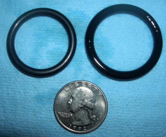

Main seal, if fluid is not red. But - the White Shepherd product has fixed many seal leaks. Here's pix of an O ring soaked in it for a couple of days.
