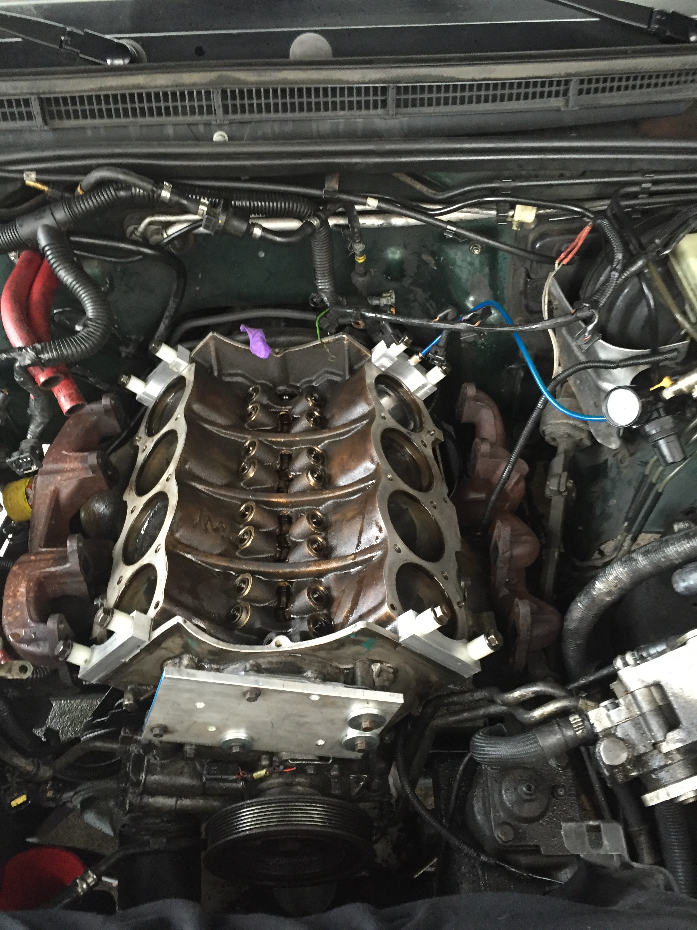

Here are some photos of the pressure test setup I made. Talking to the machine shop they test heads at 60psi. I think I should check the block again.
Notice the carbon cleaning on the heads. The piston tops have an even coating of carbon. Anyone good at reading these? Blow by?

nice simple setup.
one question for you could you have left the water pump on, and just looped the intake and discharge hoses?

You mean the discharge hose on the intake? I did fasten some rubber over the pump inlet with a hose clamp and it slowly inflated then exploded. I decided to check out the impeller on the pump anyway so I just took it off and made a template.

Only one hose left with the heads and intake off.
