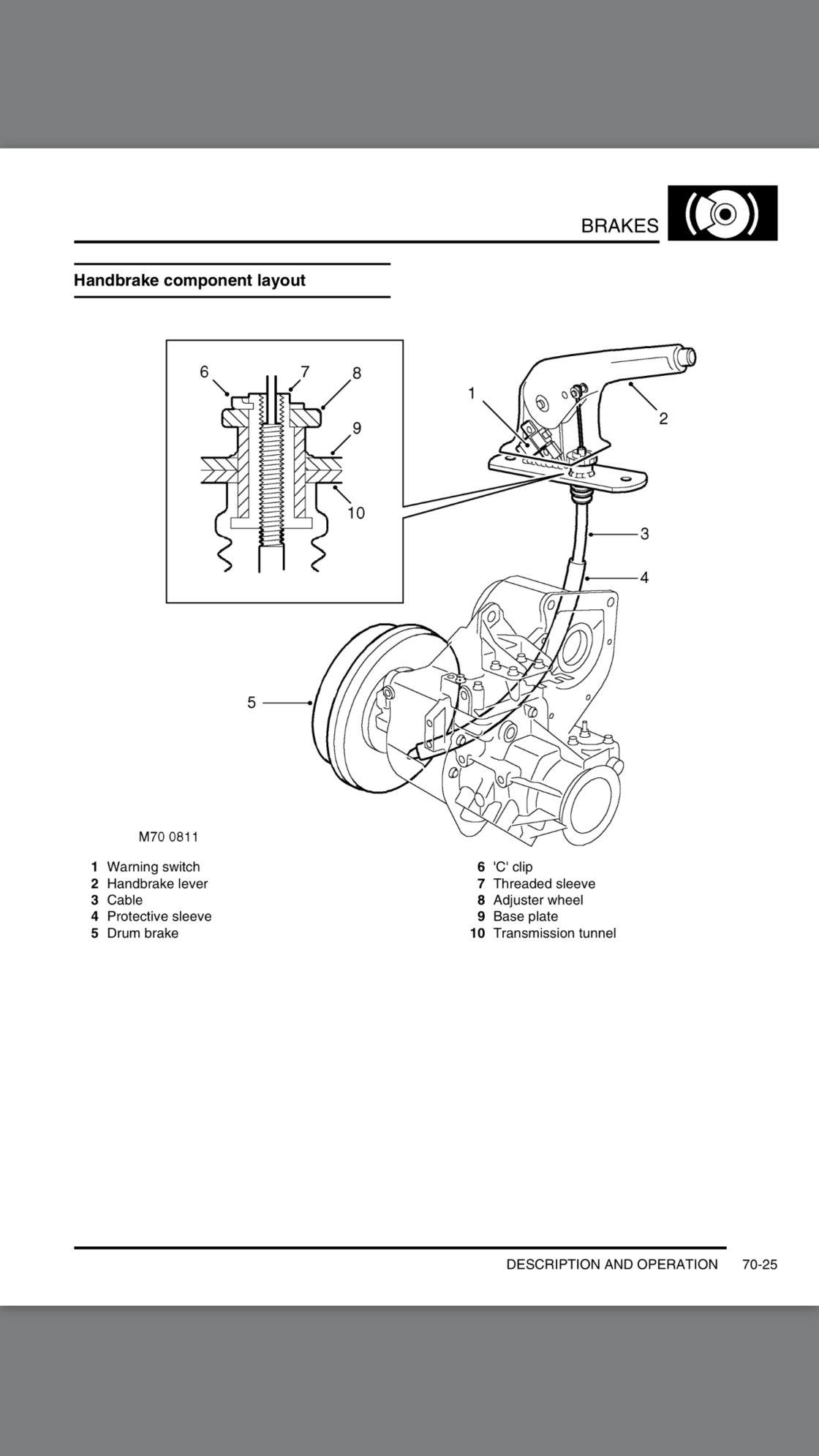

could be a bad sensor for the handbrake
Old Jan 27, 2017 | 11:12 PM
Luckyjayb's Avatar
Joined: Nov 2016
Posts: 1,611
Likes: 112
From: Bham, Alabama
Old Jan 27, 2017 | 11:15 PM
Luckyjayb's Avatar
Joined: Nov 2016
Posts: 1,611
Likes: 112
From: Bham, Alabama
Hope this will help out with your handbrake issue. It's probally a faulty switch but the 3 amigos are another monster in themselves.
