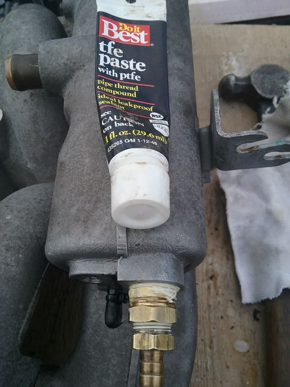

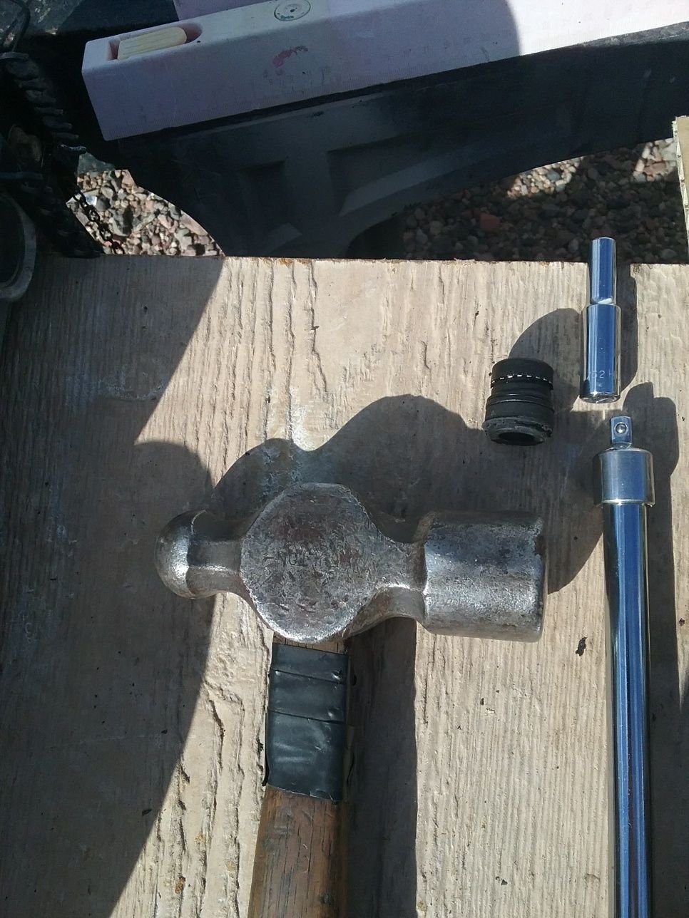

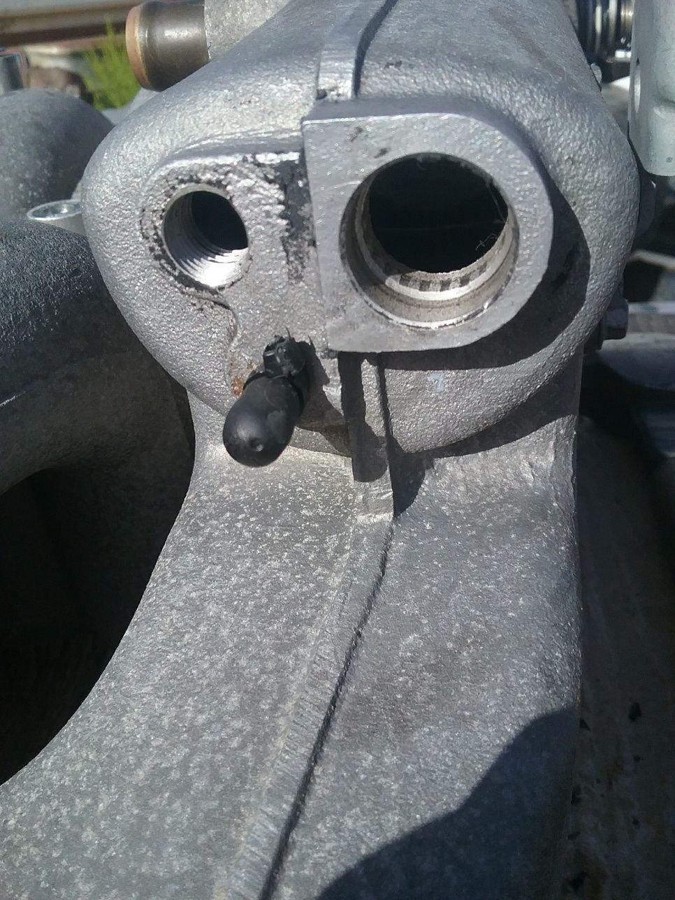

I just did this myself. Got rid of the red "thingy".
I couldn't stand this any longer.
Was doing maintenance anyway, this is the plenum removed. Prop open the throttle plate.
A hammer, an extension, and a deep well socket that fits inside the fitting snugly to punch it out.
After punching out, it will need to be tapped for a barb fitting. I used a reducing bushing for a 3/8 MPT x 3/8 hose barb.
I didn't need to drill, a 1/2 in NPT tap worked. The threads are shallow, but will hold.
Done! The other hole takes the FV308 PCV valve upgrade.
