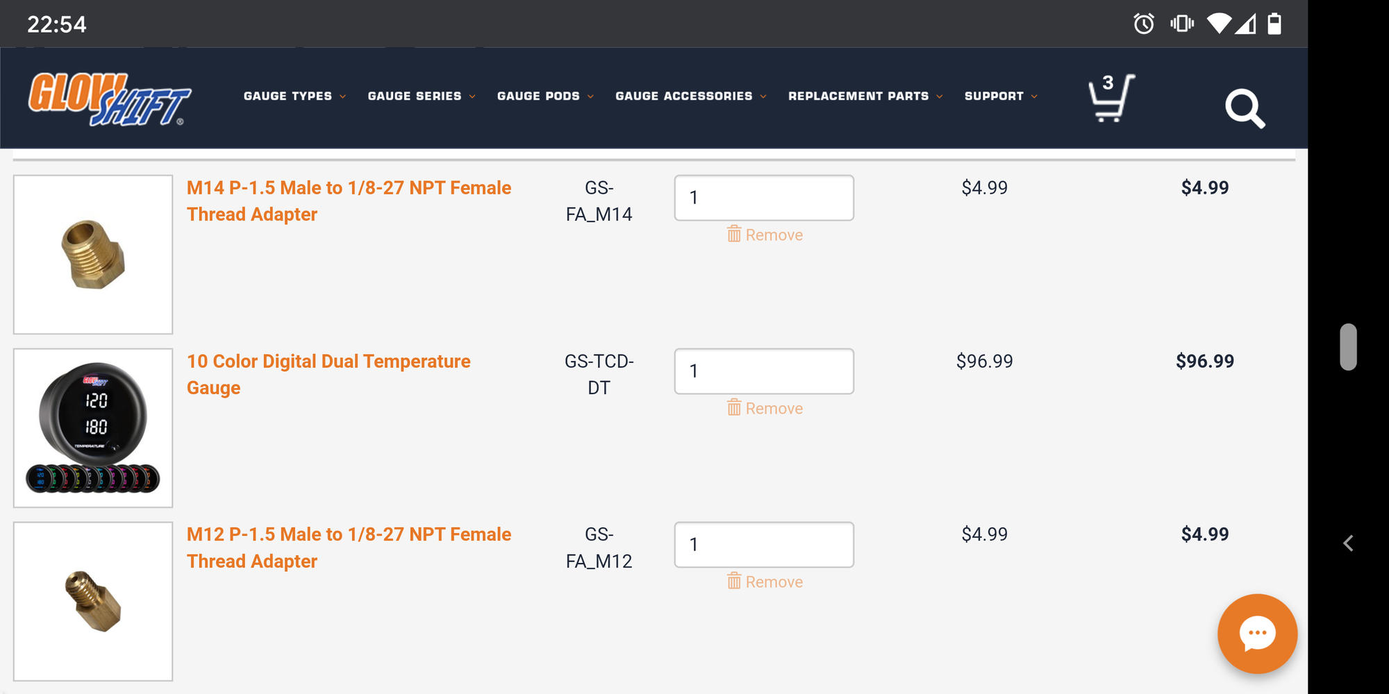

For the T/C I installed an M14x1.5 sensor (red dot) already. There was a bolt in it, no sensor:
