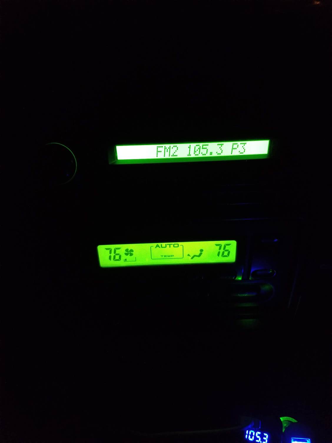

Not sure if this is alright but i'm just trying to keep the forum less cluttered. I'm also having an issue with the radio and a/c, the accent light wont light up so I can see what to press at night. Is there a bulb in there that I can change?
