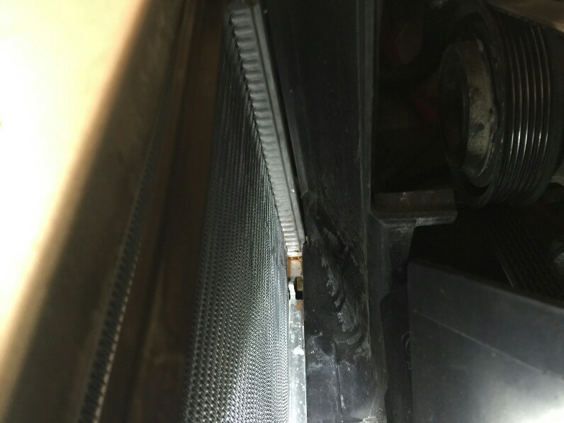

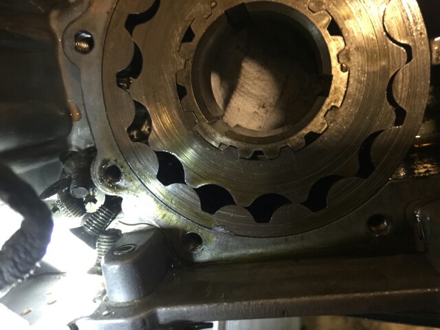

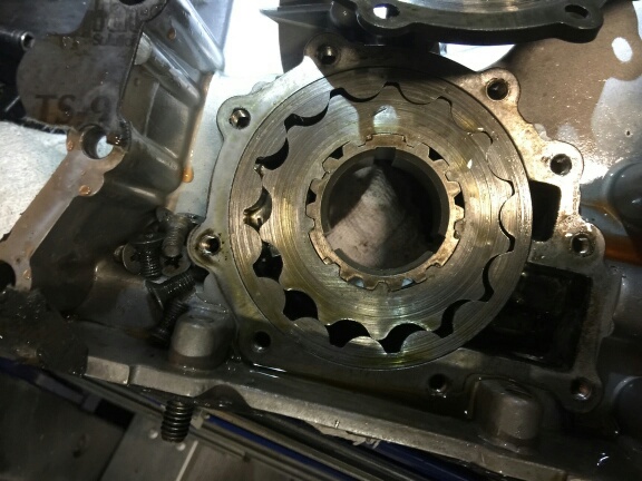

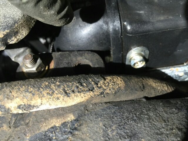

The pictures reflect what my new CannibalV8 5.0l BG Signature engine with "turnkey" installation looks like after just over 1000 miles & $12,000.00 invested. Steve Johnson personally cranked up the RPM's in front of me telling me "that's where the engine was happy", to cover the oil light & bad rebuild of the front cover. When I demanded it be repaired later that evening & the following day, he blamed it on the pressure sensor and told me not to worry about it as the pressure was good by mechanical gauge, and to put a piece of tape over the light if it bothered me; the oil pump has subsequently failed. He took my good (non-leaking) radiator & installed a replacement (leaking) radiator, padded the bill with numerous now known not to be true to add-on's to jack up the final bill. Now, a month after he initially agreed to repair the engine at his cost and make it right under warrant (both verbally and in writing), he just avoids my calls, replies with meaningless emails and texts, or promises to call back later, but never does.

In the picture that oil pump looks pretty much fine. I see one crack in the outside edge of the outer ring, so it should definitely be replaced, but it would still hold pressure just fine until it cracked all the way through to the inside. Definitely wouldn't cause the pressure light to come on. I wouldn't call that pump really failed (yet).
Also, why did he replace your radiator? I'm sure you asked or he gave you a reason. Sometimes replacement rads leak, so I wouldn't worry about that unless he wouldn't replace it.
What kinds of add-ons are you talking about? How do you know they're not true?

My guess is the front cover itself is out of spec and that is causing the oil pressure issue. Might have led to the pump gear cracking as well.

the pump looks fine can no one else see all the destruction in the gears.
the face of the gears should be smooth not or spiral like that, those are gouge marks from the pump cover.
rotorgen oil pumps do not fail just because the are cracked,
the work of very fine tolerances.

That's a real bad deal. I recall speaking to someone at cannibal about my engine woe in the last couple of months and the fact that I might have to buy one of theirs and they used the word "scalloped" to describe oil pump damage like that (the speculation was that my oil pump was not turning correctly). The advice to me was that the front cover and oil pump would have to be replaced. Putting another oil pump in would result in a repeat of the damage. Luckily mine wasn't scalloped. Unluckily I had worse problems.
