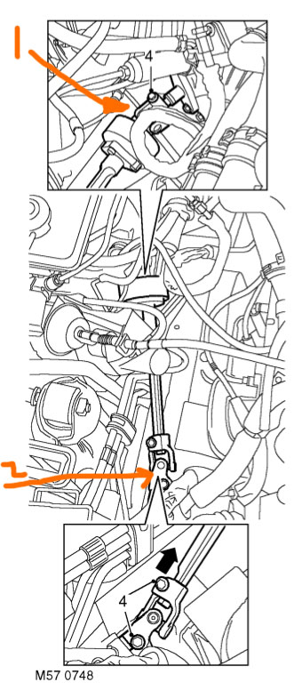

is this what your referring too.

If you are talking about the nut for the lower ball joint I don't see how you are going to remove the knuckle without unbolting both ball joints.

of course life would be easier if LR did not reefer to tie rod ends as ball joints and a pitman arms as a dropped arms
