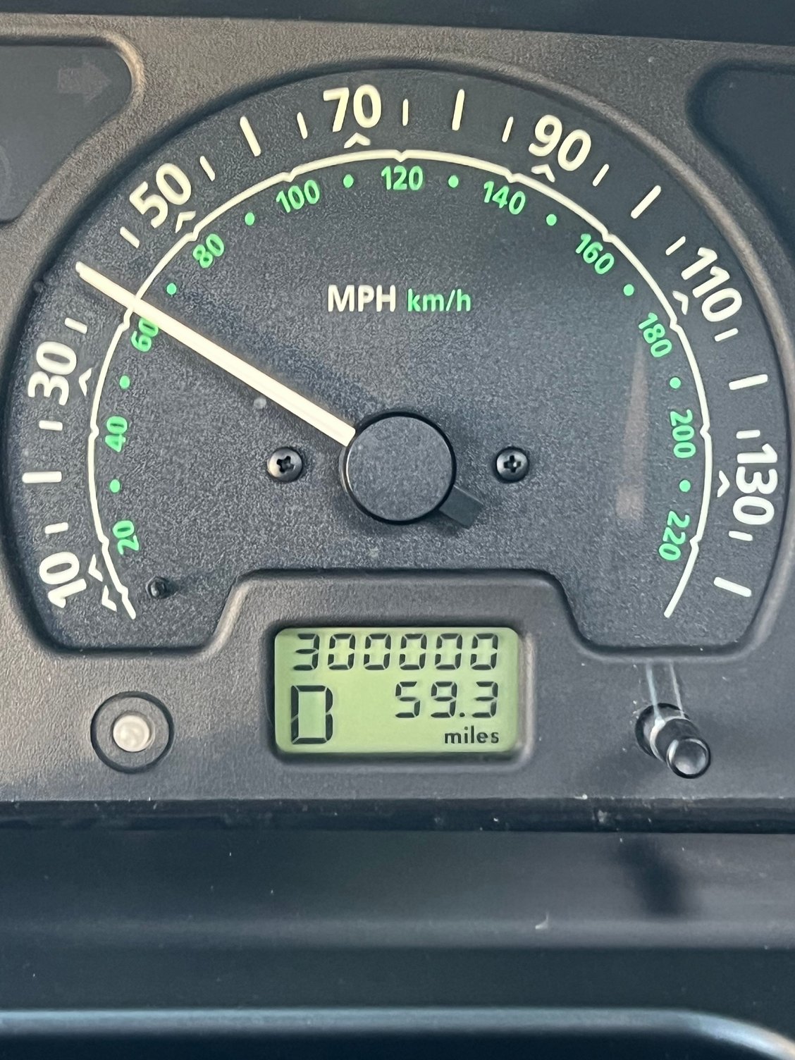

Oh, and this just happened. This thing definitely runs and looks better than new!
