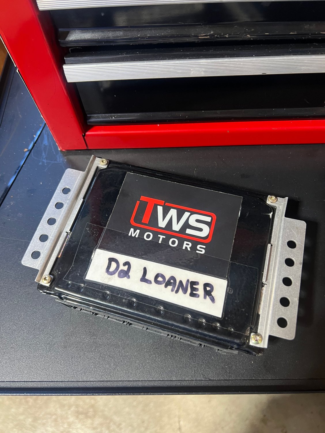

Old Apr 3, 2025 | 12:10 PM
  #67
Tony Luna's Avatar
Joined: Aug 2012
Posts: 645
Likes: 258
From: San Mateo, CA
Still at it…
Tried octane boost. I thought it did the trick, but all the misfires eventually came back.
Disconnected the MAF, idle was rougher, but otherwise ran well. Threw codes for the MAF. Still got the misfires.
I should receive the loaner ECU tomorrow and plan to install on Saturday. I haven’t done this before but I imagine the 12V gets disconnected, let it sit for a few minutes, and swap them out. Hope it helps.
Thinking CrankPS as a hile Mary if all else fails.

You have to swap the BCU along with the ECU and after you reconnect the battery turn the ignition switch on for 20 minutes and let it sit there to resync the IDM. If you move the truck no Domino's will start flashing unless you have a new instrument cluster, correction matching instrument cluster to go with the ECU and BCU
