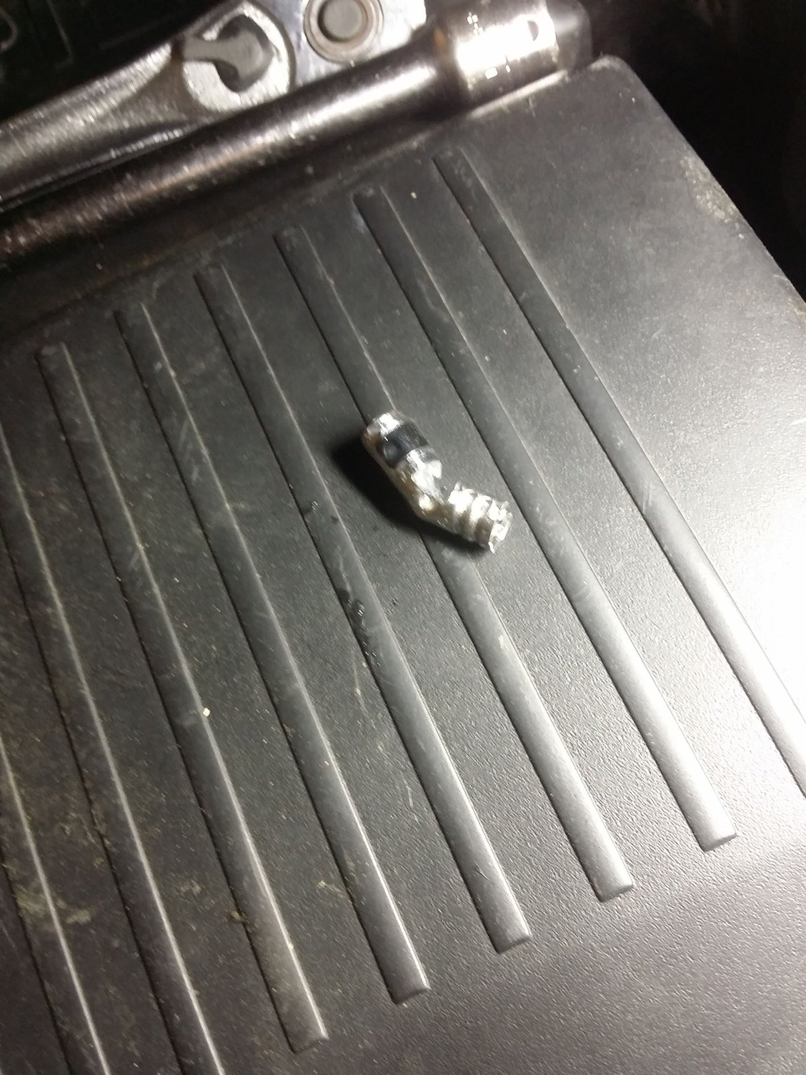

UPDATE: I was pulling plug wires to check plugs and low and behold this little gem stayed on the plug. I crank truck up with wire off and it runs exactly the same. Number 4 cylinder was not firing due to bad plug wire. Or at least thats how it appears.
