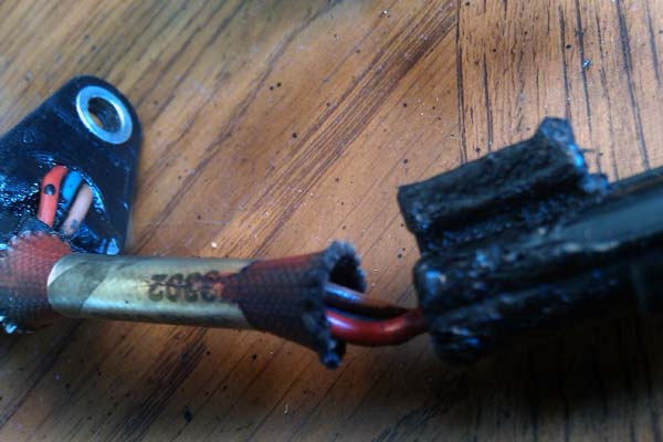

As I cleaned my oil encrusted cam shaft position sensor contacts with some CRC electrode contact cleaner, the solvent severely damaged the plastic plug. Basically it melted the section nearest the wires-ugly.
Thus I wasn't surprised when I got a 0340 code accompanied by a slight hesitation to start and a noticeable loss of power. I did the typical things like adjust the plug connection... nothing.
My conclusion was that the solvent damaged the connectivity and with such short leads I doubted repairing it was possible. So I chocked it up, grudgingly ordered a new $en$or, installed the part and cleared the code with my reader.
Surprise, I still have the 0340 code and a noticeable loss of power.
Anyone have any pointers with this? I've read that the 340 code can sometimes indicate a crank shaft sensor issue. The cost of the cam sensor just tanked me. I really don't want to put more money into her unnecessarily.

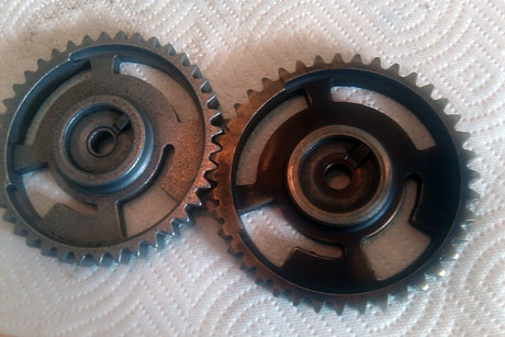

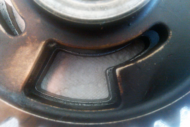

What I did discover, is that the holes (for the cam shaft position sensor) in the new cam shaft gear are not identical to the holes in the original part. The attached pictures embellish the discrepancy slightly, but none the less, there is a distinct difference.
Since the cam shaft position sensor works in conjunction with the gear holes, could a small machining error like this be enough to cause a 0340 cam shaft position sensor error? If my timing is off because of this discrepancy, can the ECU settings be adjusted to resolve the error?

I just did this job. Your timing if OFF!!!!!!
In your picture your key points straight up towards 12 o'clock. It should be point at 2 o'clock roughly. See my pictures. I also took pictures of cam and crank sprockets and you will see timing marks on them as well as the position of the crank key. Your picture does not look like this. Like I said, your key points at 12 o'clock and it should be at 2 o'clock roughly when the cam marks is pointed at 6 o'clock.
Just so you know.....marks on the new sprockets are a little different shape than the stock sprockets.
This is why your cam sensors thinks it's off.....because it is compared to the crank position.
Hope this helps. I just seen this thread...sorry. Wish I seen this sooner.
Boris
