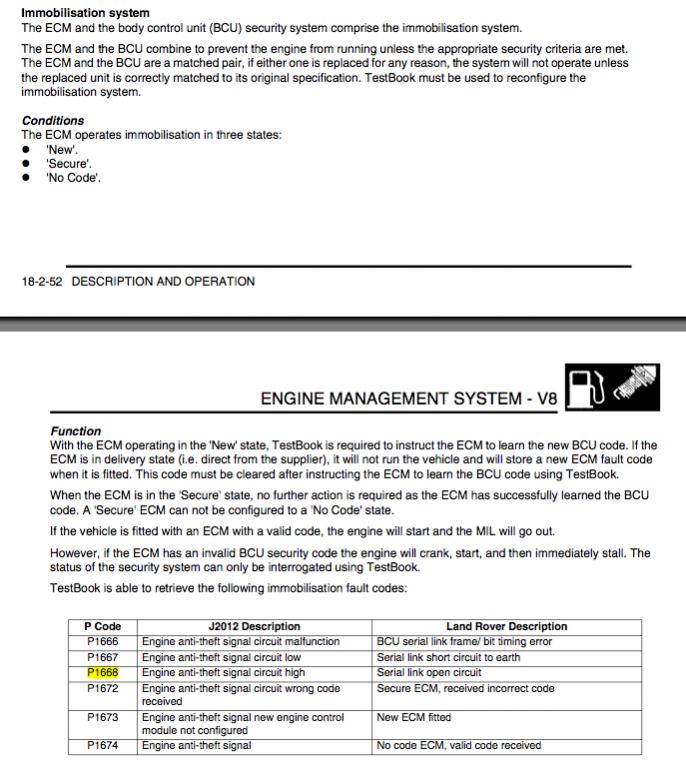

Here is the info on P1668 from the shop manual. It sounds like you have some sort of a ECM and BCU mismatch. Have you had either replaced?

No I have not. A few years back I had hit a deer and the frount drivers side took a beating. The damage was only body work. I don't think there was much else that had to be repaired.
